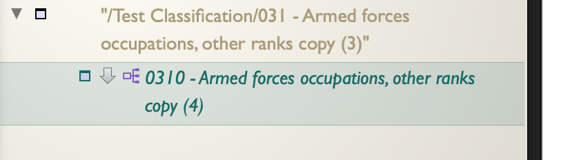

But unfortunately I DO already find the right container, it’s just that find() returns a quoted string, which is useless to me : if I make $Container= $TargetContainer, TB will create a path name including the quotes
(obviously, once I get the path right, the stamp will read $Container(original)=$TargetContainer …)
Given your screen shot, I’ll wager the quotes are due to certain characters used in the note title (or the title of ancestor containers (i.e. in its path), that make Tinderbox choke other than for simple display.

Aha. If you have a note named
Then Tinderbox has got a headache. Does
. /minutes/May 31
mean “the note named “/minutes/May 31” or does it mean the notes named “May 31” which is inside the container “minutes”?
Tinderbox is doing its best here to say, “that really is the name of the note!” But (as you have seen) this way lies various flavors of inconvenience.
My suggestion: change all the “/” characters in your notes to something else. Colons, or hyphens, or spaces.
Similarly, if you’re going to do things like this, you don’t want semicolons in your note names. find() returns a set, and semicolons separate set elements. So, a semicolon in a note name is going to require similar special treatment.

So it turns out the culprit was the parenthesis (brackets) at the end of the names. If I take them out, find() returns path without quotes.
I knew enough not to have semicolons and slashes in my names. Now I know I can’t have brackets/parentheses…
