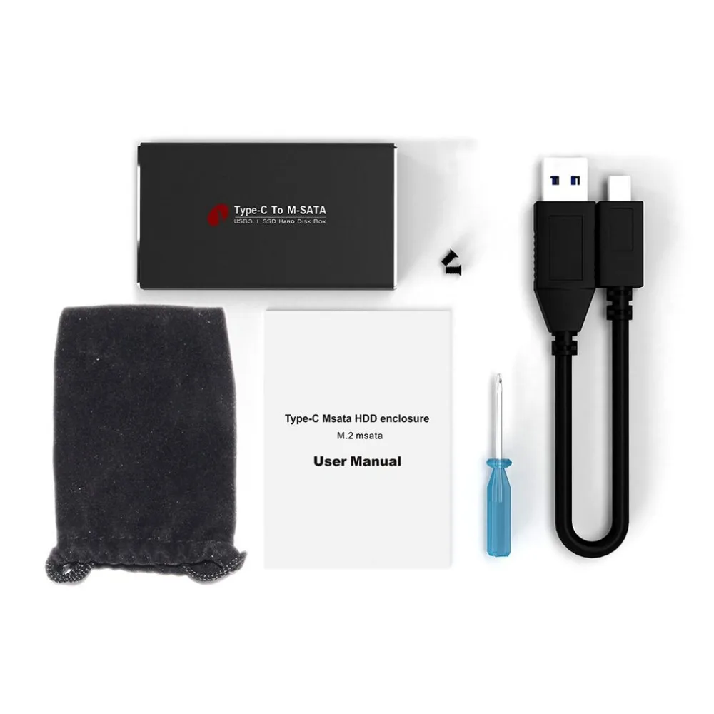

FWIW I recently acquired a tiny (1.8") used 128GB SSD from Toshiba in atiny metal case, which is fast enough to boot High Sierra and play all those 32bit games. I have a bit of velcro on my Macbook’s lid to attach it to, and a really short cable, so it’s not even an nuisance on a train or so.
It only took a couple of minutes to clone the relevant parts of my MacOS installation via CCC, and I found it also helps my productivity that I now deleted all games from my main MacOS. Best €50 I ever spent on hardware. :grinning:
