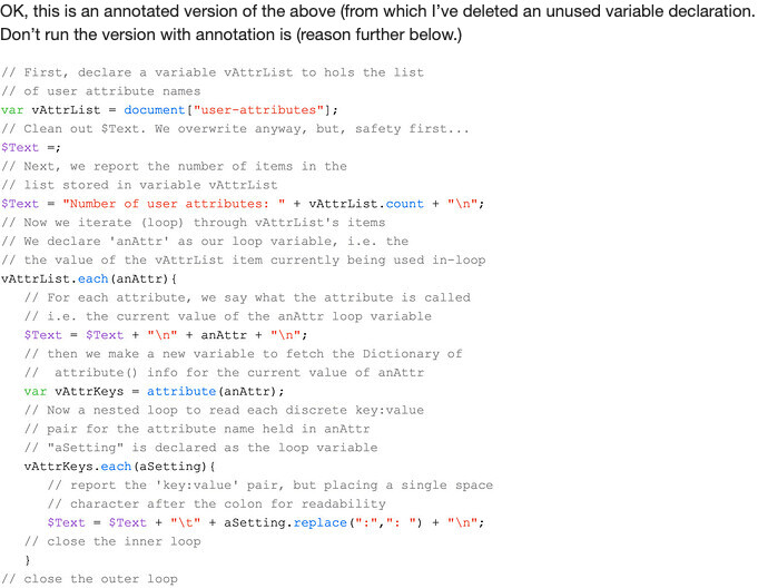

Here is the script you provided as an example in response to the original post, but with some LogRec calls inserted to log what was going on when this script executed. The revised script looks like this:
// Example: Capture User Attribute details by Mark Anderson
// First, declare a variable vAttrList to hold the list
// of user attribute names
var:list vAttrList = document ["user-attributes"];
LogRec(StampLog,vAttrList);
// Clean out $Text. We overwrite anyway, but, safety first...
$Text=;
// Next, we report the number of items in the
// list stored in variable vAttrList
$Text = "Number of user attributes: "+ vAttrList.count+" \n";
// Now we iterate (loop) through vAttrList's items
// We declare 'anAttr'as our loop variable, i.e. the
// value of the vAttrList item currently being used in-loop
vAttrList.each(anAttr)
{ // For each attribute, we say what the attribute is called
// i.e., the current value of the anAttr loop variable
LogRec(StampLog,anAttr);
$Text = $Text + "\n" + anAttr + "\n";
// then we make a new variable to fetch the Dictionary of
// attribute () info for the current value of anAttr
var:list vAttrKeys = attribute(anAttr);
LogRec(StampLog, vAttrKeys);
// Now a nested loop to read each discrete key: value
// pair for the attribute name held in anAttr
// "aSetting" is declared as the loop variable
vAttrKeys.each(aSetting)
{ // report the 'key: value' pair, but placing a single space
// character after the colon for readability
LogRec(StampLog," => "+aSetting);
$Text = $Text + "\t" + aSetting.replace(":",": ")+"\n";
// close the inner loop
// close the outer loop
// The end
