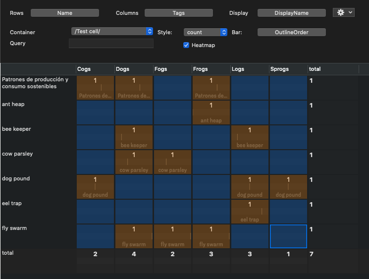

This reminded me that TB has already included another rich view included requiring no action code on the part of the user: the Crosstab. Using the same TB file it was trivial to generate the follow view
Taking the $Tags value of “Cogs” as an example which is summarise in the first column of the cross tab (and the first line in the HTML table in the first approach above) you see the following:
  • the Name of the two notes that contain “Cogs” e.g. “Patrones de producción y consumo sostenibles” & “dog pound”. These appear in brown.
  • the total number of notes containing the tag “Cogs”. The number 2 at bottom of the column tells us this.
  • a clickable link to each note with the Tag containing “Cogs”. These are the vertical stripes you see in the brown boxes in that column.
  • you can also export the resulting counts information as a table in a csv or tsv file if that is useful for you.

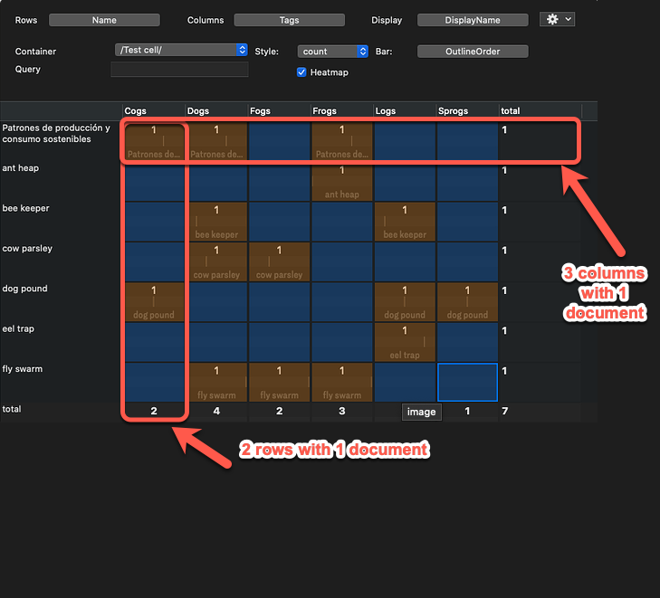

@eastgate I also note what I think bug in the CrossTab view. The totals on the right hand side do not reflect the counts across the rows e.g. for the row “dog pound” is should be 3, not 1.
Hmmm…I’ll take a look.
I was just thinking about this. I think the current implementation is correct. The total is counting the rows. I think something like this might help:
Add a Row Total in addition to the column total. Also, to be complete we may want the null (what Excel calls Blank) column.
There a two totals (bottom row and final column to the right). It’s still not clear to me what information they convey. My assumption is that they count the number of documents across all rows in the column above (bottom row total) and number of documents across all columns with a given row (final column to the right) as illustrated below. If that is the case then the total in the final column on the right does not reflect this.
I’ll check on this.
Thanks - most important to me to be clear what information the total column/row convey. I’ve not found any mention in the TB Help entry or in the aTBref crosstab entry.
I think I see where the issue possibly lies - using number vs non-number attributes. In the example in aTbRef example image:
Two numerical scores (Ii.e. Tinderbox attribute Number type) are displayed. The ‘total’ in each row or column is the total of the bin counts (the figure above) the box. In the example above the automatic bins span all data in each axis so each row or column no data is unplotted.
But example in @mdavidson’s last post, IIRC, the X-axis bins are set to unlimited so each name has a line, plus tags can appear in several notes and notes can have multiple tags. I think this is confusing the issues. The row total is basically saying there is one item in this row (correct). However, the column title is instances of tags. There are 15 discrete uses of (6 discrete) tags sow the column count total is 15.
So I think using Crosstabs with multi-value (List, Set) attributes is likely the root cause.
Also, it would be useful if the community has some text/example Crosstabs TBX to use as a common reference. It think there needs to be >1 because—as intimated above—purely numeric use is slightly different in use/nature to multi-value lists.
