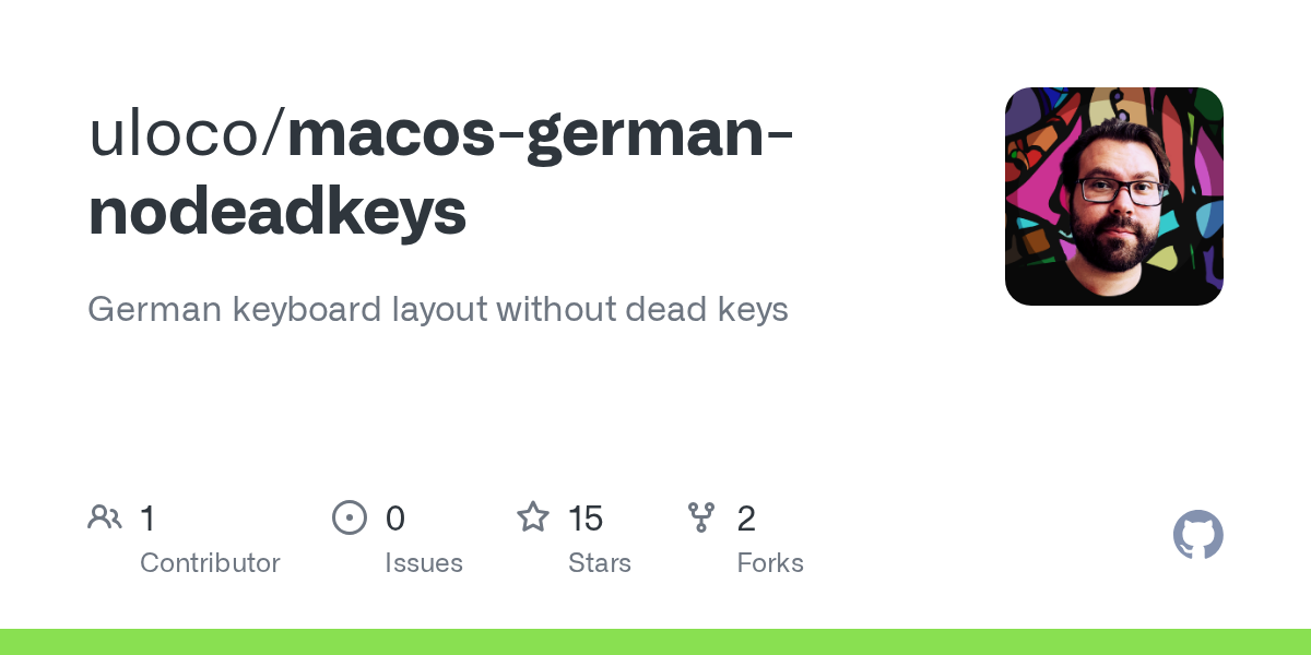

As far as I know, one can also use the keyboard layout “German (No Dead Keys)” – then the ^ key should behave like on US/GB keyboards. Until now I never had a reason to switch, but this is clearly a good reason to change the layout. If German users do that, maybe they never encounter that behaviour at all.
It might also never happen if you always finish the ^ with a space (I will test that). So perhaps only a small number of specific cases remain, and even then the error only occurs sometimes, not every time.
However, I have to admit that while I can switch to the NoDeadKeys layout on Windows and Linux, I haven’t found how to do it on macOS yet.
Yes, I’m using a standard Apple keyboard with German key labels, not just a German keyboard layout.
Unfortunately does Apple not deliver a German (No Dead Keys) - Layout. But: it can be installed later via github:
It seems, that this might solve the problem (but further verification needed).

Yes. There must be a (hidden) distinction, otherwise the behaviour is not explainable for me. Now, after I´ve installed the German (No dead keys) keyboardlayout I wasn´t able to reproduce the error. I’m cautiously optimistic that this (handling ^ as a non-dead key) is the solution to the problem.
