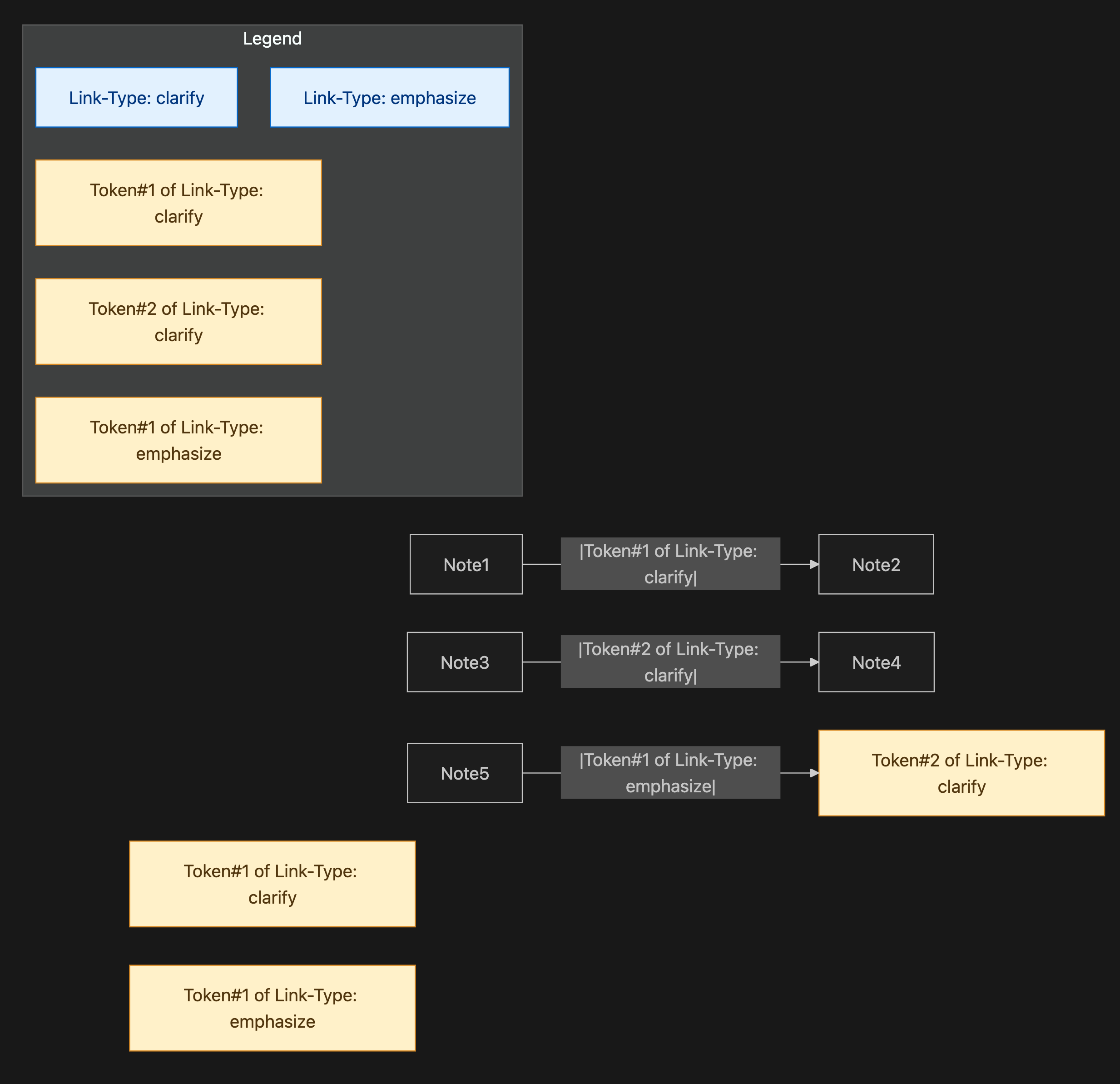

Iāll try it with just a flowchart. Maybe it will become clearer what is meant when the attempt is made. For example, being able to link a Note to a token of a link type, to emphasize that a token of a link type is itself a kind of note, which, as a token, is an individual of the more general link type.

In your model (screen grab above) āToken #1ā and āToken #2ā could be enacted as link types but not as ad hoc properties of a link type.
I sense you may be wanting to have links be first class objects (āNote 5ā appears to target another link). Is this the case? I ask is it is a non-trivial design change.
Iām interested, can you describe what practical problem token resolve that can only be resolved this way? I ask so as to understand whether the underlying issue is Tinderbox doesnāt support your imagined/preferred way of working or whether there is a type of problem it cannot resolve.
Indeed: It is, of course, about first-class objects. I understand that this is not currently a feature set in Tinderbox. However, it emerged organically from the discussion linked earlier in this forum, and thatās why I wanted to lay it out explicitly here again.
