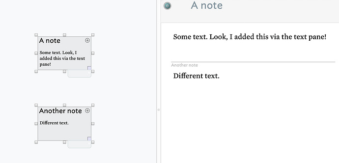

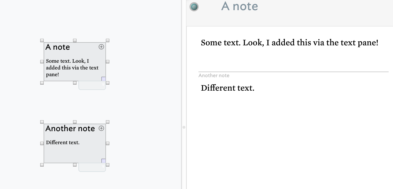

But, testing in a new v1.7.0 (b797) TBX:
I can edit text:
This would suggest the issue is either in your app or doc as opposed to in all docs/installs. Does this happen with all your TBXs. If not, I’d look for factors like automation in the TBX. Without seeing your TBX, it is hard to guess the source. Are there any rules/edicts/agents that affect with not title or text as this might be a factor?

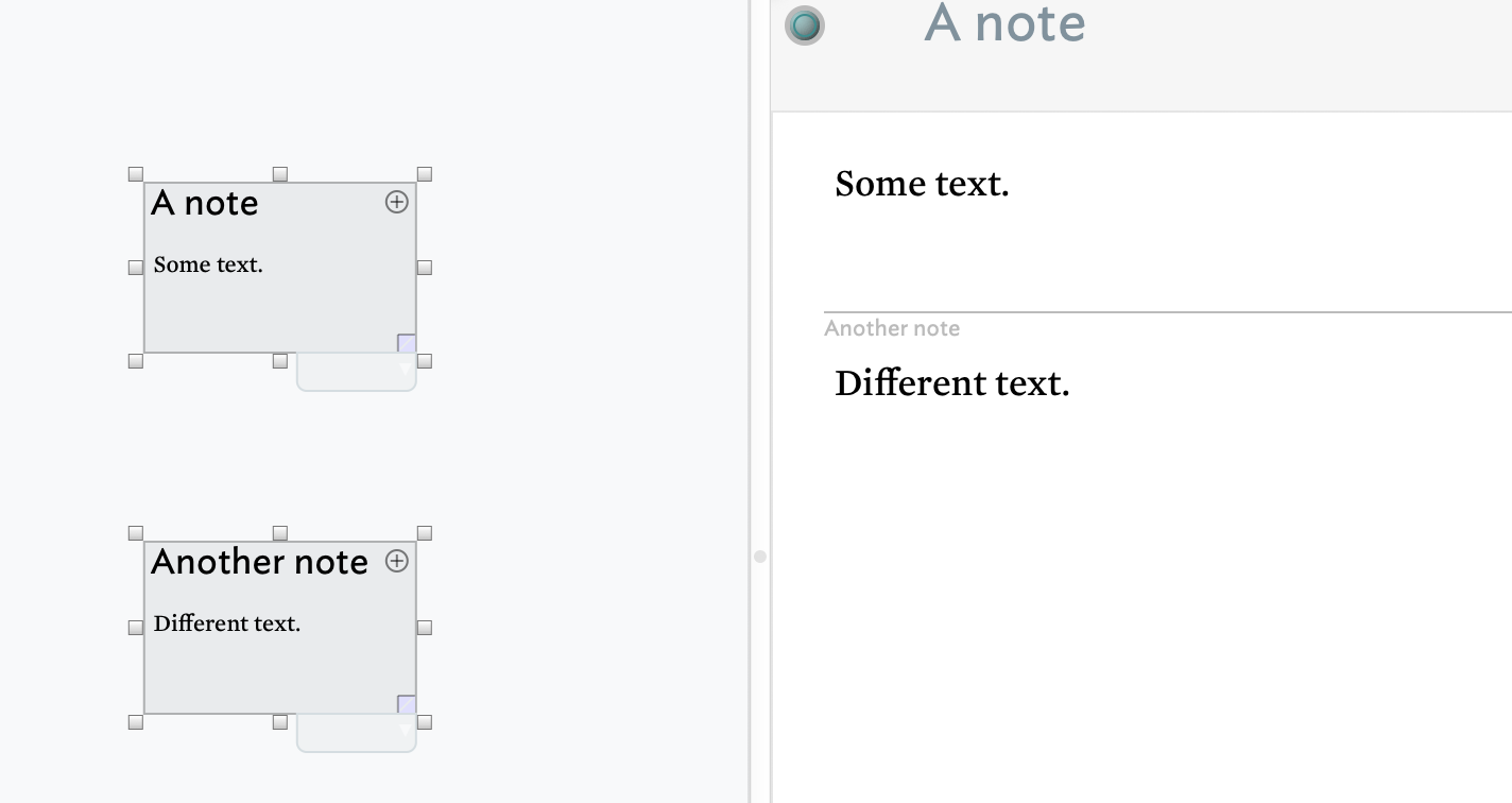

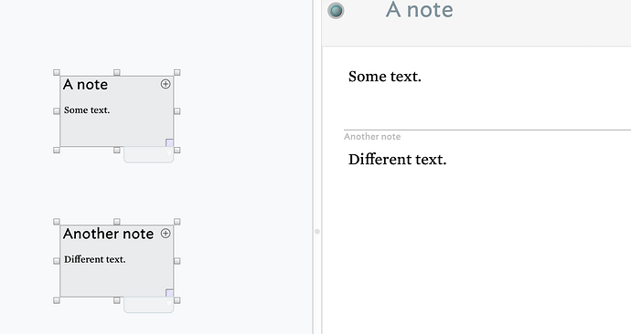

My error! The limit is 30 notes, not ‘300’ as I’d erroneously noted in the article Text pane multi-item selection (which I’ve just updated with the correct figure.). The pertinent test is now:
From v11.7.0, when multiple notes are selected, Tinderbox concatenates their texts in the text pane. When the selection exceeds a fixed limit (currently 30 notes) no texts are displayed , instead the pane is greyed out and a label ‘N selected notes’ is shown, where N is the count of selected notes.
The change was in b782 (part of v11.7.0).
So, if you see no text with a multiple selection and no $Text, reduce the size of the selection.
