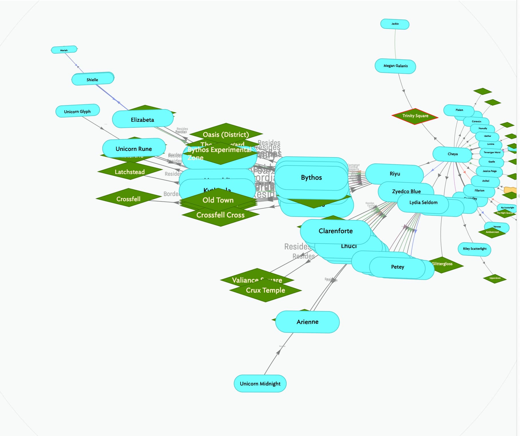

Latest screenshot:
Sorry for posting so much but I just looked at this:
As mentioned above, Anhel knows almost everybody. I think it’s fascinating (and helpful) that Hyperbolic chose to spread out those connections among other mutual links. It’s a little bit deceptive, of course, at least with cross-links turned off (currently essential), but useful… Honestly, I don’t even know if it’s because of something I did or just the software trying to be helpful. It’s very interesting, though.

FWIW, currently the hyperbolic view is laid out on a notional spherical surface. The further from the currently centred note the smaller the note is plotted.
†. In reality it think this is a hemi-spherical surface as we can’t see the back of the sphere.
Actually, it’s a hyperbolic surface.
…Oh! I remember! It would make the length of the lines/size of the box variable based on the weight. I know about the curving surface, oh yes. Everytime I need a break in writing, I switch to that tab and swing the view around, back and forth, back and forth, ooh, spin it… that kind of thing. It turns out to keep me on task far more than looking at random webpages!
Uh, so, yeah! Long lines would push out smaller boxes, because they’re not important to what you’re looking at right now, but they’re not irrelevant, either. It’s the sort of thing I’d intuitively do if I had to display something with many dangly bits on a seriously curved stand. Sort of like rays on a common sun icon?
