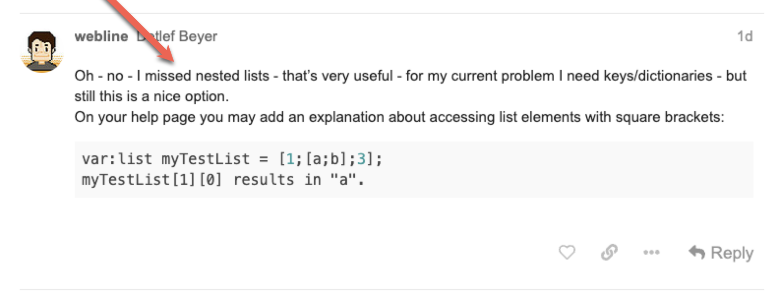

var:list myMatrix = [[0;1;2];[3;4;5];[6;7;8];[9;10;11]];
$Text = myMatrix[1];
failed because the logic that performs indexed references was removing brackets too aggressively. This will be fixed in the next backstage release.
Note that the correct way to represent a list of lists is the one above:
[ item1; item2; item3; item4 ]
item1: [0;1;2]
item2: [3;4;5]
