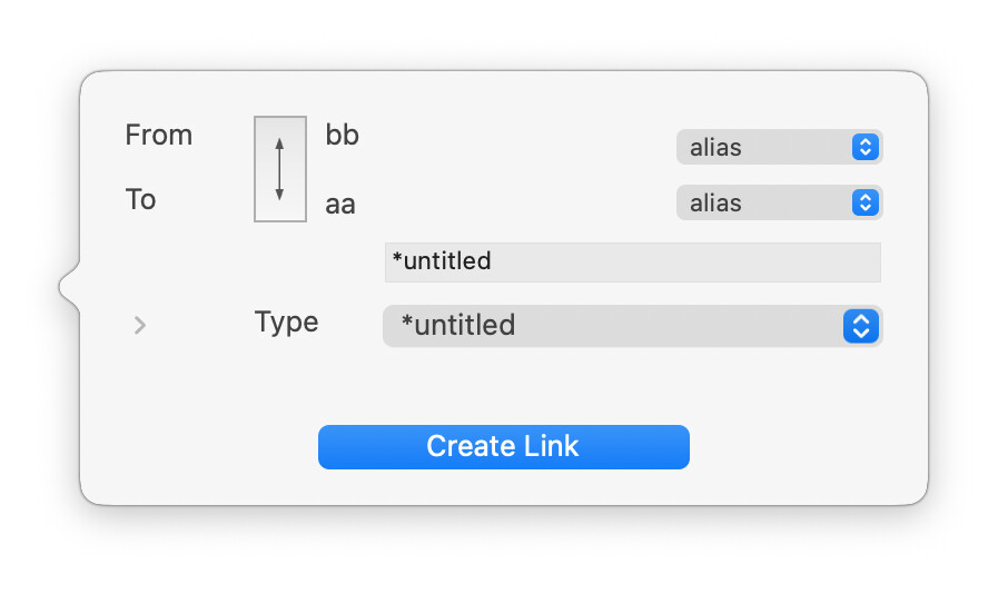

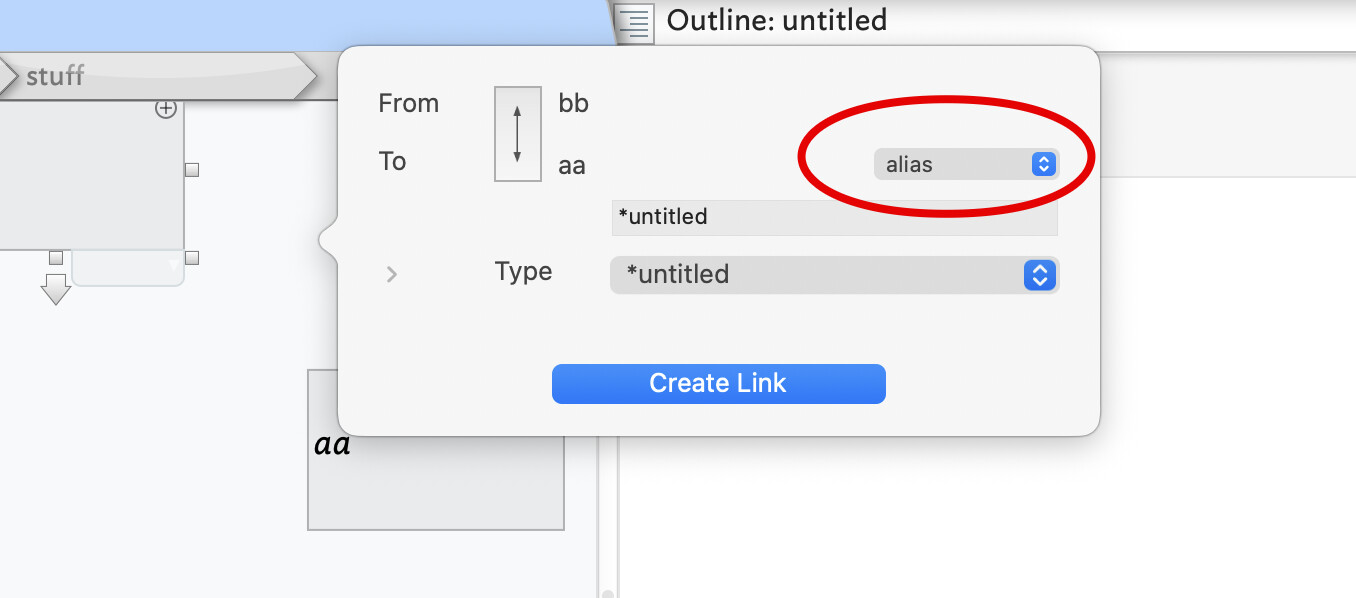

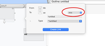

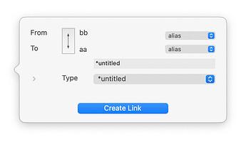

If using aliases (most likely in maps) note that when dragging links to an alias, the popup (circled) allows the link to terminate at the original and not the alias.
Indeed, if dragging between two aliases, both can be altered so that two originals are linked despite the linking context being two aliases..

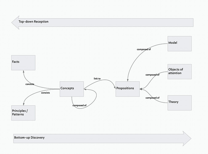

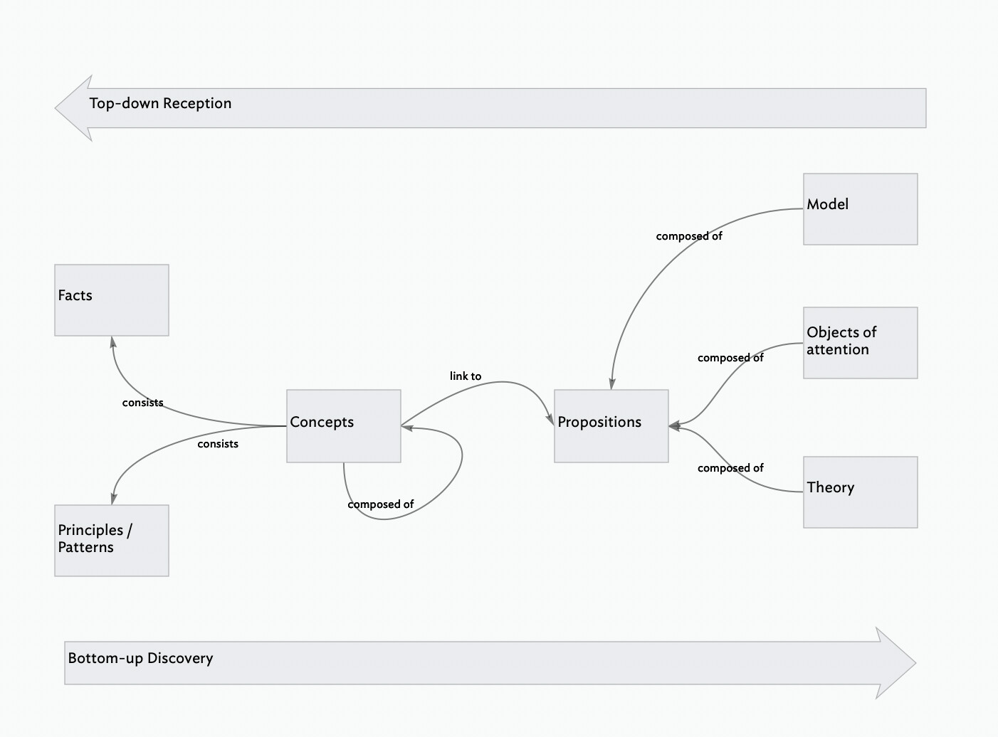

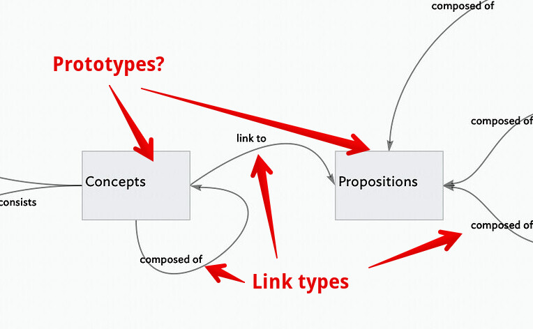

Here’s the workflow in my mind:
  1. Process a source and create hierarchical reusable blocks, blocks being those that are on the screenshot I provide. Theory are containers of propositions, propositions are containers of concepts and principles etc.
  2. Reuse those blocks multiple times when synthesizing across different contexts without losing access to the source structure.

Tinderbox composites were intended for this sort of thing, but your current data scheme is probably too complex for composites. (It might be interesting to try, though…)

My data scheme is quite simple actually, don’t be overwhelmed by the names. It just means create a container every time you want to go deeper and picture the corresponding idea with dots (concepts), linking words and formed propositions.
It looks like you are after a re-useable set of notes/links to pre-populate new maps (of new investigation. For such blocks I see two constituent elements:
