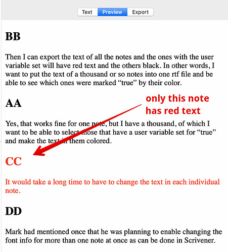

In the demo, 4 of 5 notes use the prototype we’ll use to select notes for export. One of these ‘CC’ (shown) has $MyBoolean ticked:
I’m using an agent ‘Text export’ to apply the export template and with the agent selected I ensure the text pane selectors are visible (Window menu ▸ Show Text Pane Selector) and then I click the ‘Preview’ selector and see this:

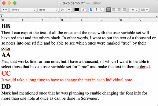

Now I click in the preview, select all (⌘+A), copy (⌘+C) and can now paste into Text Edit, Scrivener, etc.:
Once set up, this is a far easier route to your desired end point even if it appears to use HTML en route.
