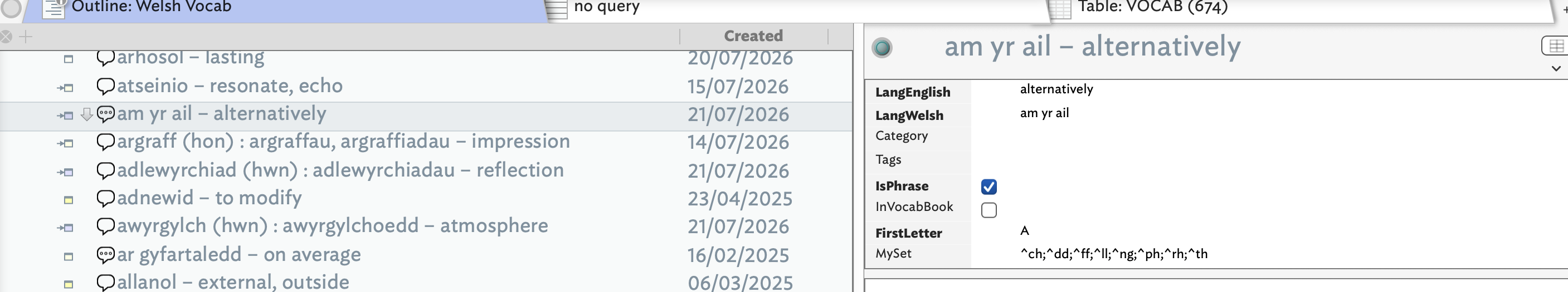

The $Name of each vocabulary note contains the Welsh headword, an en-dash, then the English definition. E.g.
am yr ail – alternatively
The prototype has the following code to split the name into two attributes $LangWelsh and $LangEnglish, based on the en-dash (which is only ever used once in a $Name):
	$MyList=$Name.split("–");
	$LangWelsh = $MyList.at(0);
	$LangEnglish = $MyList.at(1);

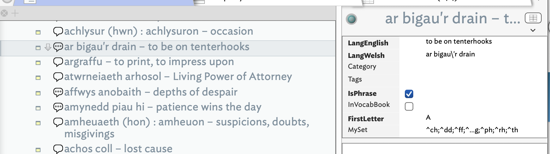

This works very well, unless there is an apostrophe in the $Name, when it becomes escaped with \:
(Note that $Names have dumb apostrophes, ' not .)
I can work around this with an additional .replace("\","") of course, but I wondered whether this is simply an inevitable artefact of the way split works, or perhaps a bug?

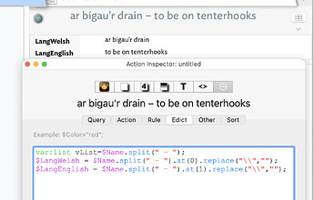

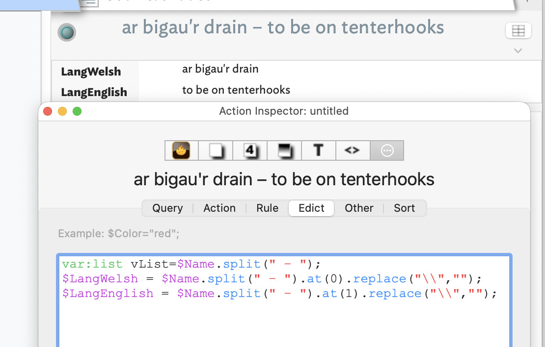

Either way, this still is not the desired result. A workaround for now (tested):
var:list vList=$Name.split(" – ");
$LangWelsh = vList.split(" – ").at(0).replace("\\","");
$LangEnglish = vList.split(" – ").at(1).replace("\\","");
  • The spit, you actually want '- ’ , i.e. with the padding spaces, not ‘-’ to avoid stray white space (seen in $MyList in your code).
  • New the code works, we don’t want to use an attribute (that we don’t reset) so store an interim state. A ‘list’ type variable suffices.
  • To replace a backslash—Tinderbox’s own escape character_we need to escape it, so \\ not \.
