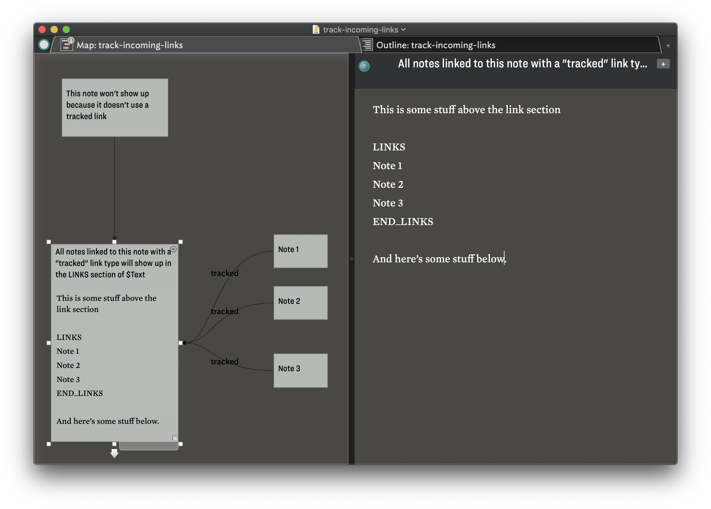

It seems to me that the big feature that TBX is missing here is the ability to create text links with action code. If this were possible, it would be a relatively simple task to create an edict that adds links to all incoming notes to $Text.
For example, here is a TBX document that has a note that uses an edict to collect the names of the notes that link to it with a link of type “tracked”, and puts their names in a LINKS section of $Text:
track-incoming-links.tbx (133.4 KB)
Screenshot for those not wanting to load up the file:
Unfortunately while we can put the names of the notes into $Text, we cannot link to them because adding text links with action code is not supported. However, given that we can now format strings with action code via string.bold et al, this seems like a natural extension of functionality. @eastgate is there any chance of getting this functionality?
