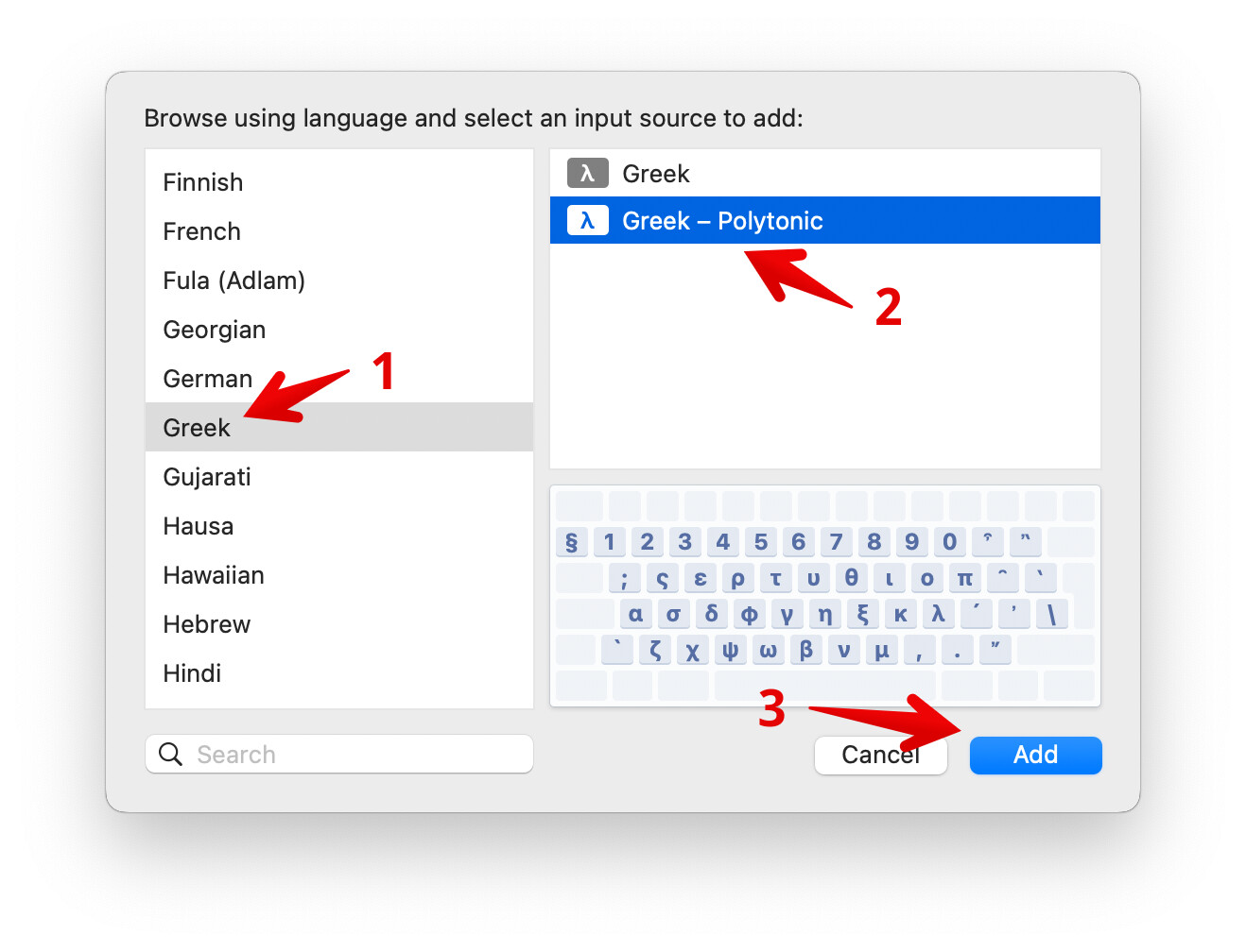

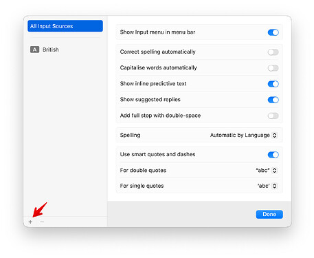

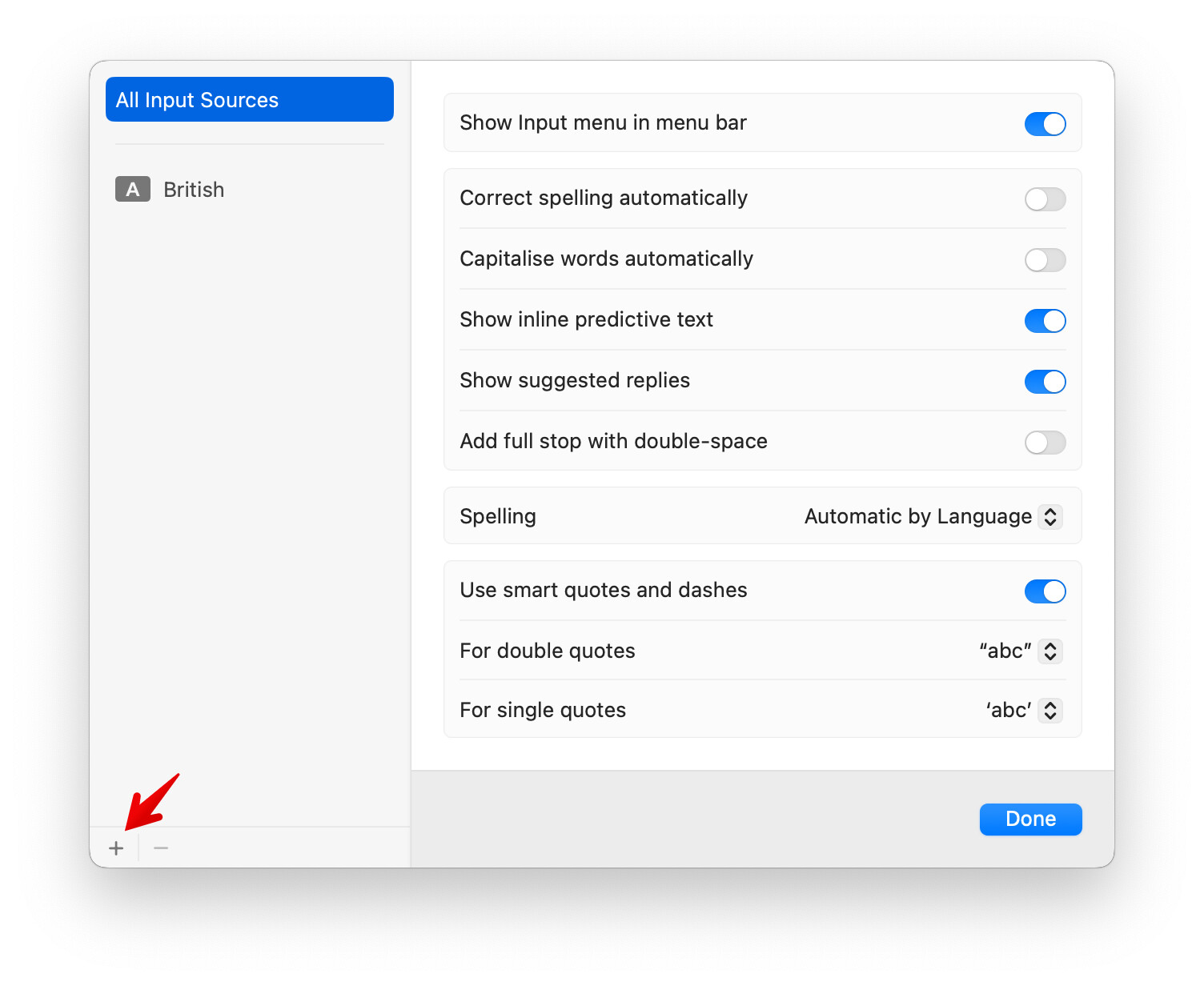

macOS’s Times New Roman is certainly able to supply (ancient) greek characters and diacriticals. You can check that by opening macOS System SettingsKeyboardText Input and clicking the Edit… button. Then in the panel that opens click the ‘+’, lower left.
Then in the left column:
1.pick ‘Greek’
2. in the filtered content top right click ‘Greek - Polytonic’. Note the bottom right panel shows the characters/accents added by which key when this input method is selected in macOS settings
3. Add.
Now, by setting Greek - Polytonic as you Mac input method you should be able to type greek characters (in Times New Roman), if only to prove the font is likely not the issue.

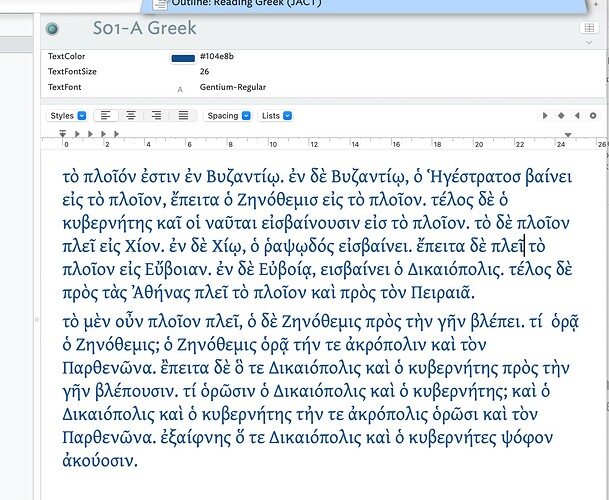

If the font you choose doesn’t have Greek characters then the Greek text seems to default to Helvetica.
Personally, I use Gentium (free downloadable font), which was recommended somewhere I can no longer remember…

The latter should enable you to paste the ancient greek into a Tinderbox note. However, you might want to first check that the note’s $TextFont (i.e. the default font used in the $Text area of the text pane) can show the ancient greek characters you reuire. So, test this before doing any such pasting as above.
I’m glad @brookter recommended the Gentium font. I’d seen it suggested but having no personal experience of that thought it best not to give an untested suggestion.
