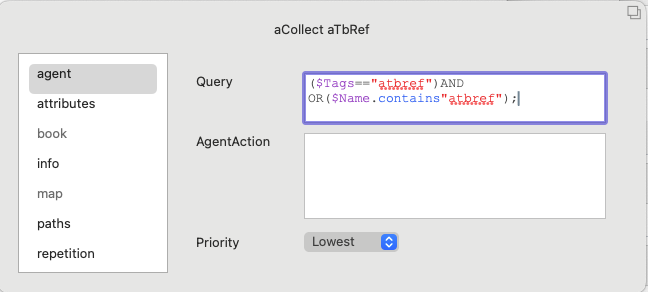

Agent - query - how to chain multiple attributes - OR?
Hi, I’ve done quite some searching but can’t seem to find an example simple enough..
As I’m working to better understand how to use Agents, I’d just like to use two conditions with either / or (and is also allowed).
I’m using an attribute “atbref”.
I also use “atbref” in $Name.
If I use ($Tags==”atbref”); I correctly get all notes with $Tags==”atbref”
If I use ($Name.contains”atbref”) => I correctly get all notes from which $Name contains “atbref”
But how do I just chain these two conditions?
I’ve done some trials with OR and also with | but these don’t seem to work the way expected..
I’m aware of the existence of “DisplayExpression”
Further down the line, I would like to be able to e.g. find / locate items with multiple ways of spelling (or misspelling for that matter), but I would also like to learn how e.g. to strip parts from $Name and put these in their own rightful “attribute” etc.
Thanks for helping out!
As you’re using aTbRef, have you found the action operators: the query logical AND join, the query logical OR join? See more on query syntax.
There is no way to ‘chain’ queries, which in Tinderbox would imply a ‘dot’ connector. Queries are written in action code but used logical operators. Thus, to join multiple discrete query term you use either an ‘and’ (&) or ‘or’ (|) operator. Using database style AND, OR and NOT will not work.
Either/both join types can be used if you have more than two sub-queries. Queries are parsed (understood by the app) read left-to-right. As with a spreadsheet formula you can affect the order in which sub-parts of the overall query are read by using parentheses to control parsing order; see Conditional statements using multiple arguments.

See the == equality check for why $Tags=="atbref" doesn’t match other case variants. Note in that article the section explaining why == works differently with multi-value attributes: $Tags is a Set type attribute.
Invalid syntax. See String.contains(regexStr), note you’ve omitted the necessary parentheses enclosing the operator’s argument. Actually I’d suggest you likely want String.icontains(regexStr) if you want a case-insensitive match.

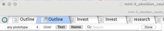

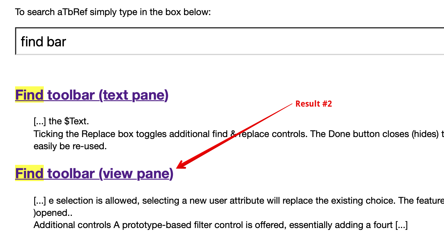

This: Find toolbar (view pane)?

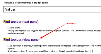

Did you try the Search page in aTbRef:
Note that the view pane and text pane both have Find bars but they work slightly differently.

I repeat, you can’t chain queries, in the way you can dot-operators in an action. You need to use & and | logical joins. I’m not trying to be pedantic: using the terminology the app uses makes it easier to search the available support materials. For instance if you search aTbRef for ‘chain query’ you will get some results but they don’t relate to joining queries. Search for ‘join query’, and the and/or join articles are the two top matches.
In the same way the documented syntax matters. This is wrong:
$Name.contains"atbref";
Tinderbox will try to guess what you mean but, as you’ve found the results are not as expected.
Note: although written in action code syntax, queries never use teminating semicolons, even for a single query. If going multiple queries, joining operators must be used.
Also, when quoting arguments (e.g. the ‘atbref’ in .contains("atbref"), always use 'straight 'quotes. Here you likely did that but annoyingly the forum software auto-changes them to typographic ‘curly’ quotes. So I note this issue out of caution as a thing to check until you are more confident with action code syntax. :slight_smile:
Using the correct syntax, Tinderbox can understand this:
$Name.contains("atbref")

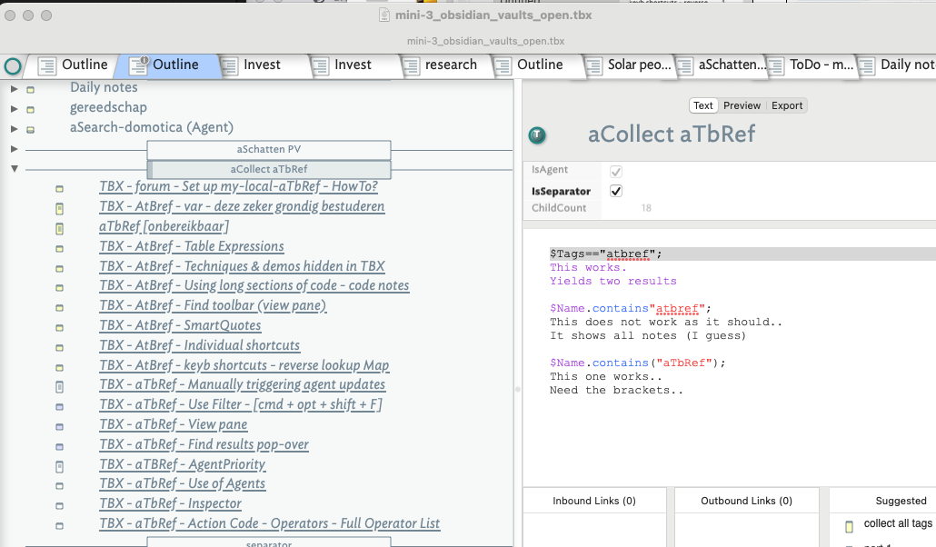

In the mean time I’ve adapted the query to:
$Name.contains(“aTbRef”);
That at least works, but it only throws 18 results. ($ChildCount => 18)
Yes, I did, at least I went the other way round, searching for cmd + F, as I knew that makes the Find toolbar appear, but I guess the “Fuzzy” logic went astray :wink:

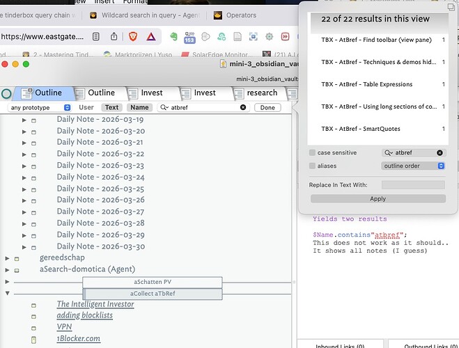

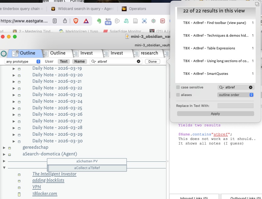

I’ll try to go more indepth with the Find toolbar, but for now, could you help me understand why the Find toolbar will show 22, and the agent 18?
results, and the why the $Name.contains(“aTbRef”) results in only 18?

Searching for Cmd+F would logically find you a page describing a page that calls a Find, such as a the Edit ▸ Find menu. Actually, Cmd+F is unintentionally ambiguous as what it opens depends on whether the View Pane Find or the Text pane Find is opened. I’ve added 2 new links the Find menu page for the next aTbRef refresh. But, even if counter-intuive, search for what’s actually wanted is a better search start here. :slight_smile:
So your agent searches only against $Name, i.e. note titles.
By default, the View pane Find toolbar (view pane) has a preset scope/comparison type. The documentation states::
By default only Text and Name are pre-selected.
So your view pane Find searches Title ($Name) and Text ($Text). In the current v11.6.0, that search is a case-insensitive string match (you can check by clicking the chevron in the search input box and checking the pop-up menu).
So, if the agent and the Find are doing different searches, then this would explain the different results.
I’ve a hunch that if you go to the view find bar and click the Text control so it isn’t highlighted, the find result will fall to 18.
