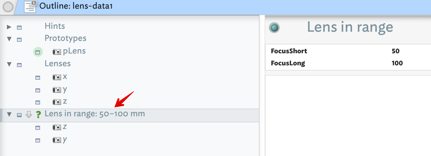

Thus:
By setting our agent to use $FocusShort and $FocusLong for the upper/lower bounds, we can test query:
Now you test query:
between($FocusShort,$FocusShort(agent),$FocusLong(agent))|between($FocusLong,$FocusShort(agent),$FocusLong(agent))
Plus, if we give our agent a Display Expression like so:
$Name+": "+$FocusShort+"–"+$FocusLong+" mm"
We get this result:
Here is the test document: lens-data1.tbx (115.2 KB)
