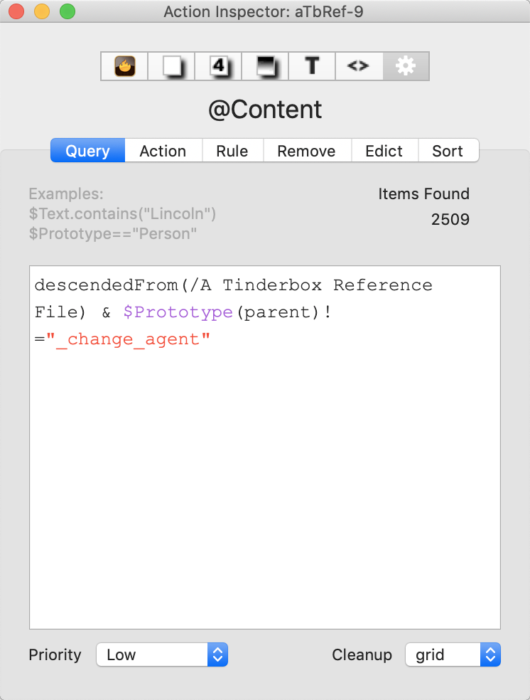

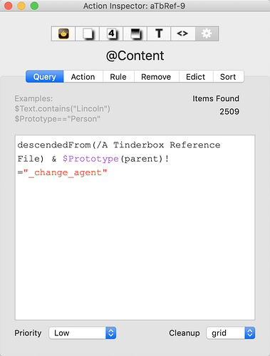

No, you misunderstand. A query must be an actual query, not code. But I think the step you are missing is the $AgentQuery holds the literal query code such as you see in the Action Inspector’s https://www.acrobatfaq.com/atbref10/index/Windows/Inspector/Action_Inspector/Query_tab.html:
You mistake is you are pasting code directly into the Query box of the Query Inspector, rather than running the code, so as to make a string that is the lister value of the query. You store that string as the value of $AgentQuery, and thus set the correct query for the agent:
