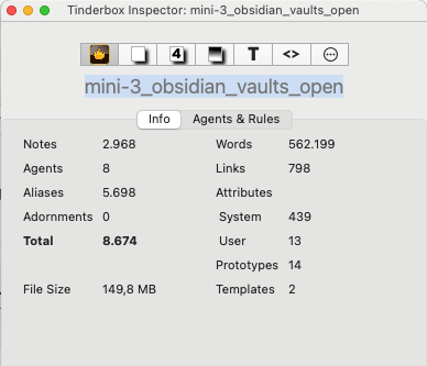

If you think agents are a performance issue this is most often a tell the you are using agents inefficiently. Likely much of the information for which you are making individual agents is catered for by one or several tabs using Attribute Browser view.
If you have 20 agents all search the same set of notes (be it all, or just a part of the TBX) and then applying one extra differing item, then the efficient way is to make one agent that search the wider set of notes. Then for the 20 individual conditions those search the first agent filtering for the individual condition.
Let’s say the TBX has 1000 notes of which the first query matches 100 notes. I the opening scenario, 20 agents search all is 20,000 searches per agent cycle. In the second method is is 1,000 + (20 x 100), i.e. 3,000. We’re now doing 15% of the number searches and still getting the same result, albeit with 21 agents. Attribute Browser is an even better method.

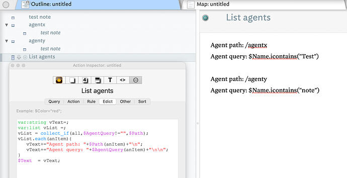

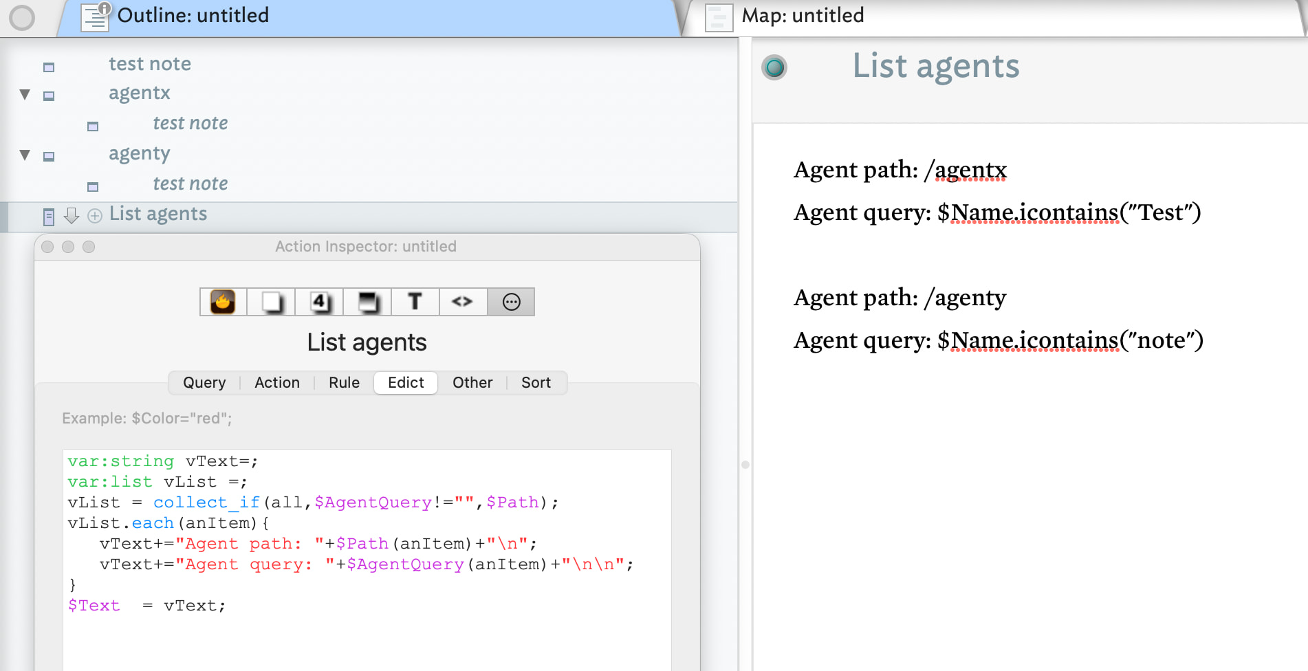

I’ll assume you’d like to alter this edict:
$Text = collect_if(all,$AgentQuery!="",$Path).format("\n");
So, each agent’s $Path is still given, followed by its $Path, with a blank line between entries. There’s more than one way to do this. I’ll use a variable to build the content and then set $Text to that:
var:string vText=;
var:list vList =;
vList = collect_if(all,$AgentQuery!="",$Path);
vList.each(anItem){
   vText+="Agent path: "+$Path(anItem)+"\n";
   vText+="Agent query: "+$AgentQuery(anItem)+"\n\n";
$Text  = vText;
Like so:

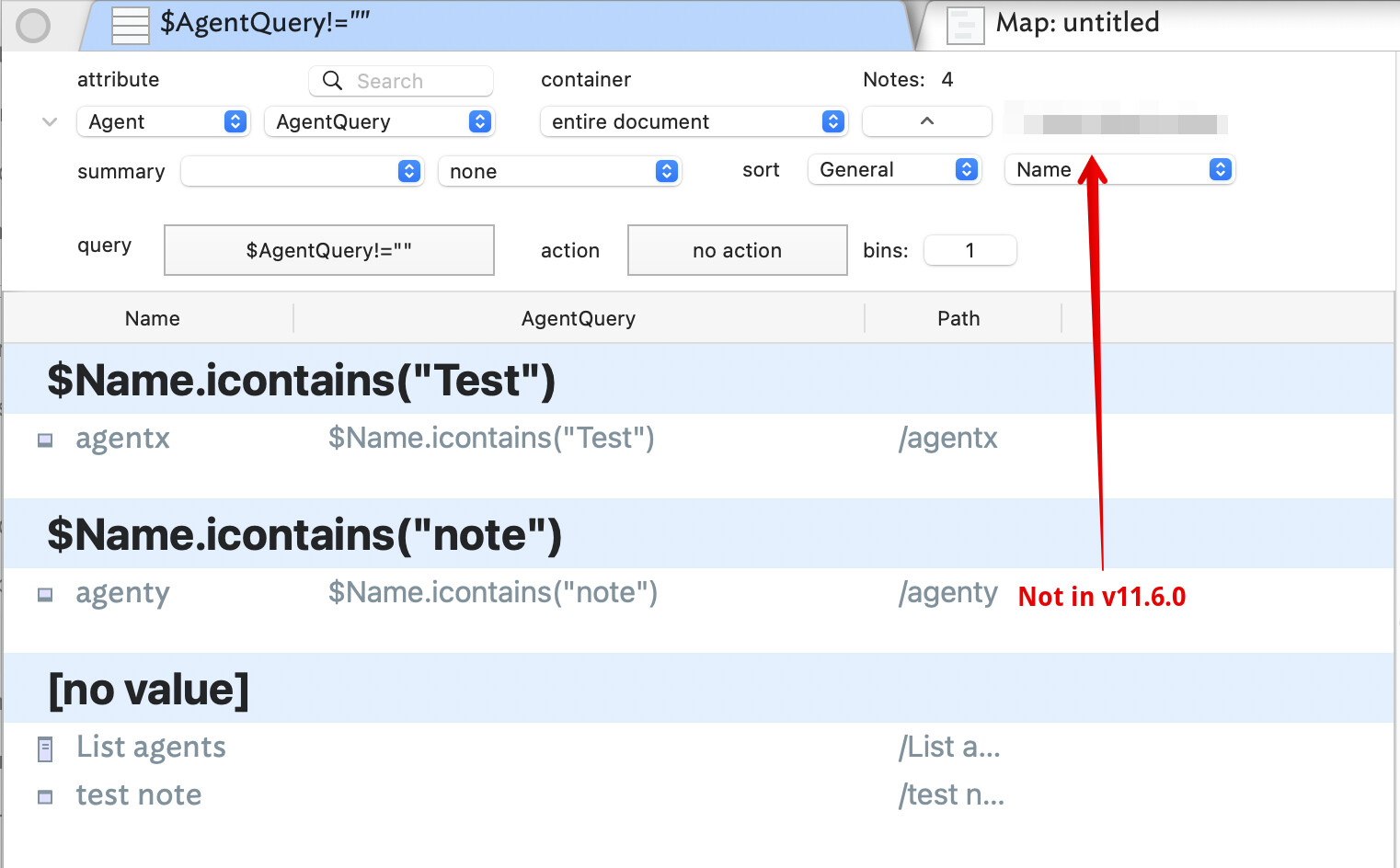

Making a table? As a table in the styled text ($Text) of the note not possible I believe. But in preview, using either HTML or Markdown, not complex. But, you haven’t stated what the table will contain, so chick-and-egg, depending on how complex your table design the more work it might be.
Frankly, Attribute Browser view would be a far better way to do this, no edict needed:
I’ve blurred a control as I used the beta and that control is not in the current release.
Tada, table and listing all done with no extra coding!
Learning format()/.format(), I’m not sure what more there is to explain than in the documentation. For a multi-value list (List or Set), the operator needs a source list (either as an operator argument or dot-chained) and a formatting string. The list is then output as a single string, the formatting string being inserted between each value.
It might help if rather than seeking ‘more help’, forcing the helper to cover every possible use (a lot of possibilities!, i.e. their free time), you were to state which part you don’t understand. Also don’t be afraid to try and fail with some testing. Use a text TBX, not your main document. Sometimes, actually assembling the parts and running the code helps much more than paragraphs of explanatory text (or video). Also trying and failing gives an immediate bounded question: what you tried, in what context, and the result.
HTH :slight_smile:
Note, I just updated the second grab so you can see the queries. If a column is too narrow you can drag it wider (there is no line wrap inside such info cells.)

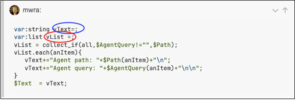

Question-1:
In your code below, you start with declaring two variables. I notice a difference in spelling between the two. Does this have any importance?
=> notice the space on the second line after vList =; (mind I have deliberately inserted 2 spaces here for clarity)

The $Path line inside your .each() loop lacks its terminating semicolon.
Thanks Mark!
I probably need a special pair of “colon” enhanced spectacles / glasses!
And that even after scrutinizing the code…
Any idea how I have to interprete the 20 empty edict yieldings?
I’m confused, I definitely did not vary the spelling the variables. Note that each variables must have a unique name and perhaps that is what you’ve missed. My code declares two such variables: vString and `vList. The older usage would be:
var vText;
var vList;
Here I do two extra explicit things, I give each an elicit data type, so the app doesn’t have to guess our intent:
var:string ...
var:list ...
and I set both to the per-type default using =;, as is documented here: Setting an attribute to (no value) via code.
vList is used to hold the result of using collect() which returns … List-type data. Using a variable adds a line of text but, I’d hoped adds more clarity for the learner as to the type of data being passed around.
vText is a String-type variable used to assemble the overall string of ‘text’ we be passing to $Text when done. Whether you make one string and set $Text to it, to add iteratively to $Text is really personal choice. You get to the same output.
Did you see the article on the `var’ operator, here: var? If so, where did you get stuck?

Maybe I used too many words:
See the extra space below in the var declaration - That what my (confusing) question was about.. :wink:
