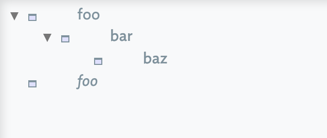

Based on @loosewire’s quotes of aTbRef (which I’d have written testing out from erstwhile Release notes) i think something is amiss. I make this simple test. In outline, 3 nested notes and an alias of the top level container.:

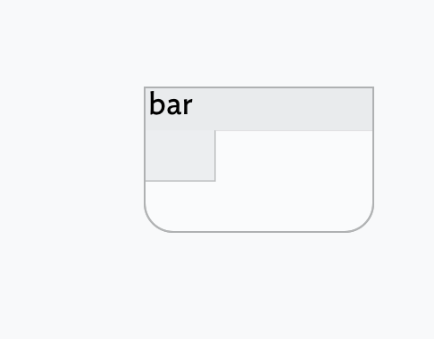

In map view, if i drill down from ‘foo’, I see:

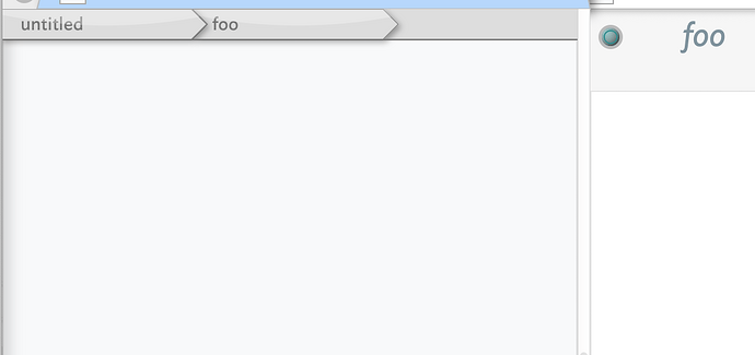

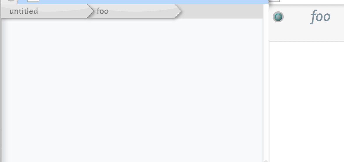

If return to the root map and I drill down (still in map view) into the alias of ‘foo’ I get nothing:
In truth, and regardless of the docs, I’m not sure what I should see. I don’t recall this issue coming up for a long time. Might this be a dark corner dinged by the v5 → v6 rebuild?
