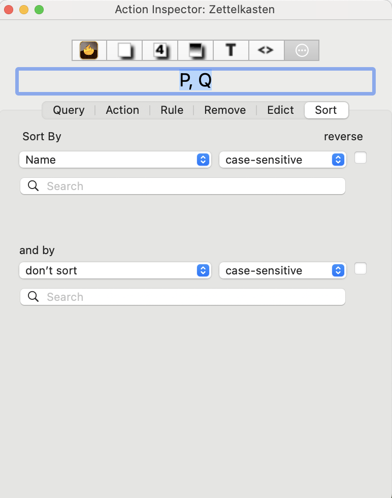

I’m missing something:

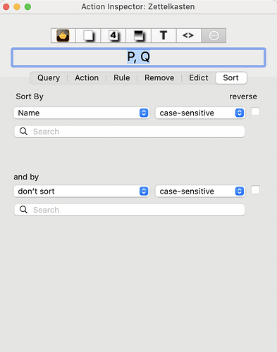

  1. I select the container I want to alphabetize (click title bar at the top of the container)
  2. I open inspector > action inspector > sort > sort by: Name > enter
  1. I then open the container, and nothing has changed, ie notes are where they were / have not been alphabetized.
Do I have to alphabetize a container note by note instead of by the container as a whole? I recently alphabetized an agent and it worked immediately so I’m confused why it’s not working here/what I am missing.
OK, ‘order’ is effected differently in map vs. outline. Sort affects $OutlineOrder, but in Map view this is not X/P position but Z-axis (front to back). This set of articles describes the difference.

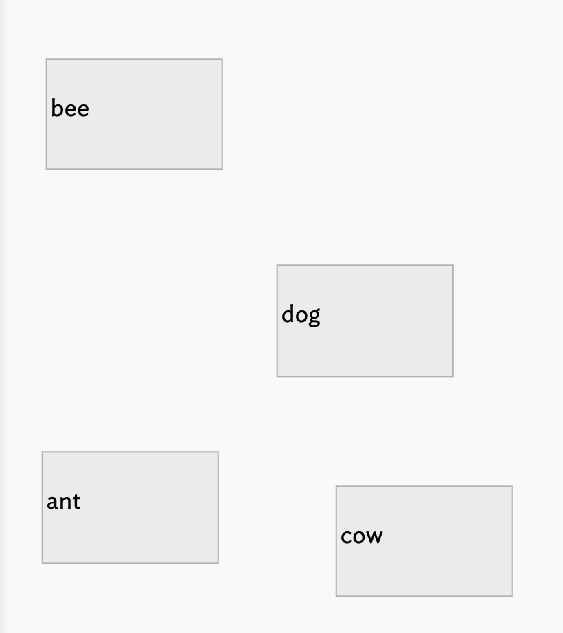

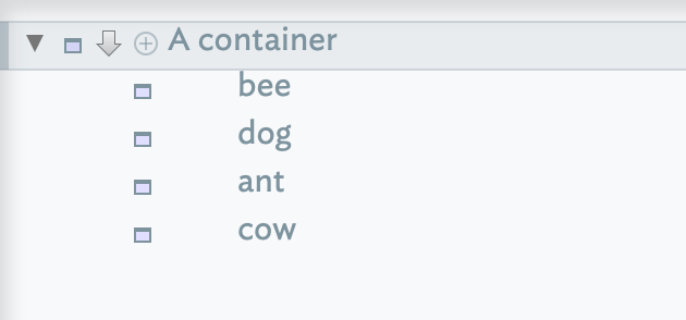

It seems you want the visual map sort in Outline order, but how does that work in a map? So we make a map:
The outline order reflects the order of the notes’ creation:

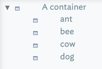

We sort the container on $Name (in the manner you describe above) and our outline looks like so:

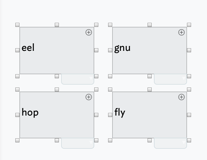

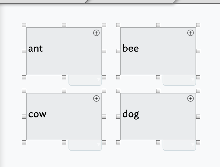

But, the map’s layout is unchanged (i.e. as in the picture above) even though the $OutlineOrder of the notes has changed. However, if I select all (Cmd+A) then View menu ▸ Cleanup… we get this, which I think is what you are after:
See more on (map) Cleanup arrangement. This same command can be called from the map background’s context menu (i.e. right-click menu when no note is selected).
The cleanup uses the map (container) current sort. If unsorted (as at the start above) a grid would simply read the map left to right, top-to-bottom. Here is a cleanup grid from note’s in a ad hoc layout. Note the grid order is not A–Z:
