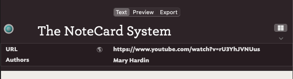

Hi there, kind of resurrecting the post.

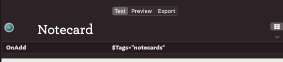

I want to add a particular tag to several notes that I created but I cannot figure out the way to do so. I saw a video on YouTube about smart adornments to add the $OnAdd attribute to an adornment so that’s what I did and tried to follow the comments from before.
The tag I want to add is “notecards”.
My adornment is like this:
But when I drag the note to the adornment nothing happens:
BTW, now that I’m asking. To write multiple authors with that attribute I have to separate them with a semicolon right? I guess it’s ok to use spaces between the first and last name.
Thanks in advance for your help.
It might help to read up on Sets, which goes into the mechanics of adding/removing list—in this case a Set-type list—values.
There are two facets this this question:
  • Where. By using $OnAdd, the code is first whenever a new child note is added (new or via drag/drop, action code etc.) or for map adornments only, if a note is placed ‘on’ the adornment.
  • What happens. See the link above for examples of sction code for working with lists.
HTH
You can also use the short cut +, e.g., $Tags+="some value";
