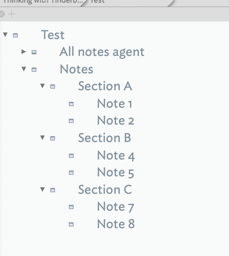

I have a container of book notes, divided into Sections, like so:

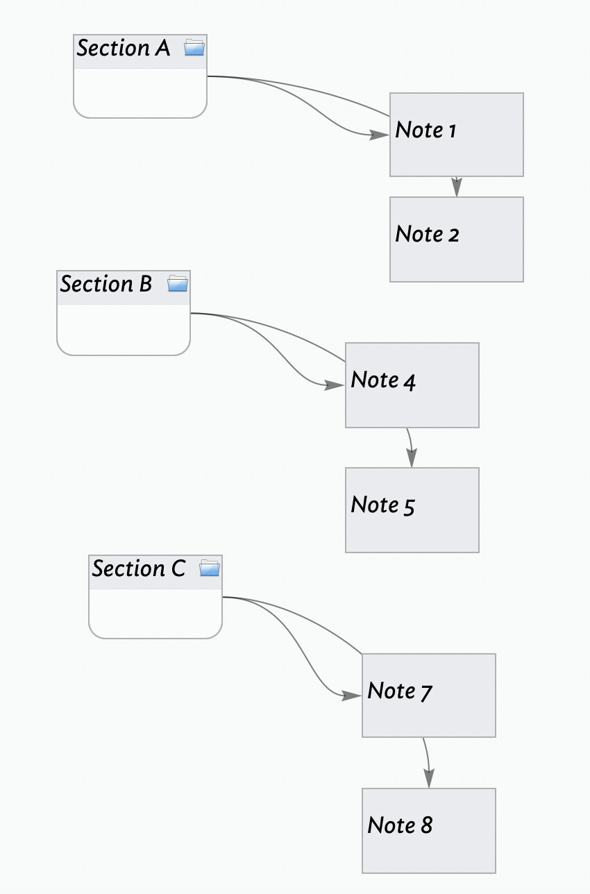

I also have an agent which brings together all the notes descendedFrom the Notes container, so of course, the Sections and the notes are mingled together on the agent map, which is what I want.
In the map view of the agent, I can manually link each note’s alias to its aliased Section, like so:

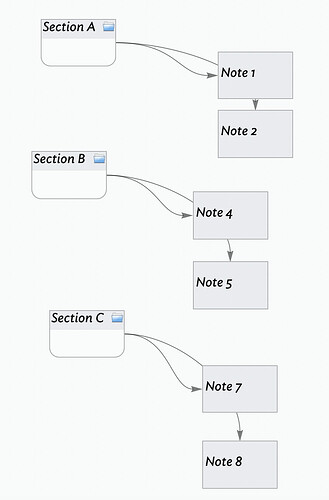

But this gets tedious if there are many chapters and notes. I’d like to create a stamp which automates this: selecting a section alias would create the links to the aliases within this map, without affecting either the original sections or notes.
I’ve got as far as the simple stamp below, which creates links to the original, but of course that’s not what I want here.

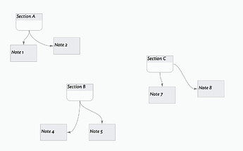

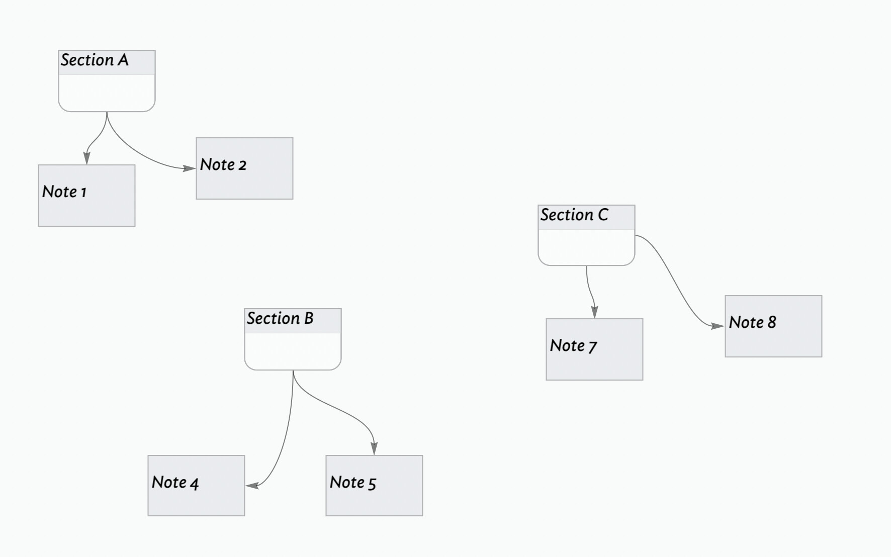

Result (on map with items manually arranged before stamp):
Tada!
