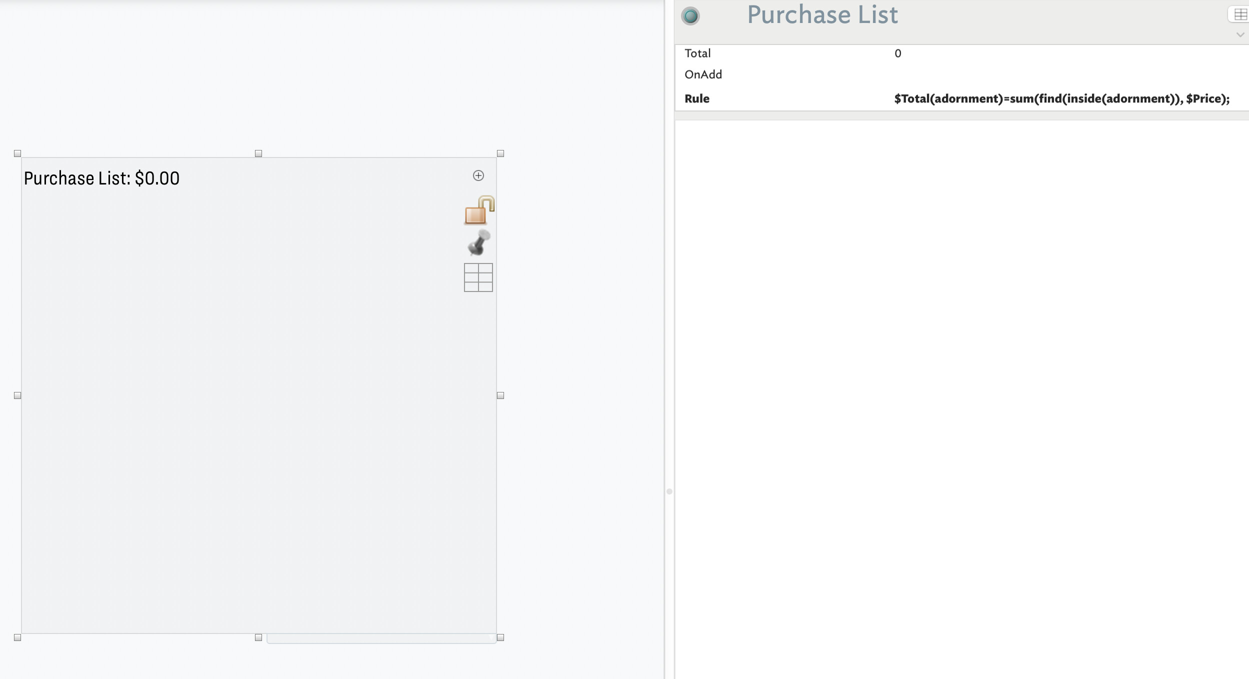

I currently have a rule inside an adornment:
$Total(adornment)=sum(find(inside(adornment)), $Price);
This works, but feels inefficient. Basically what I’m trying to do is have the $Total update every time a new pPurchase prototype is added to the adornment, adding the new note’s $Price to the adornment’s $Total.
Suggestions?
