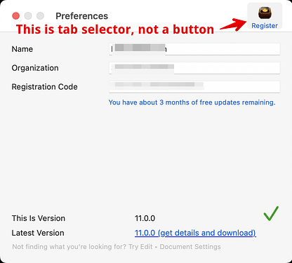

I am trying to use tinderbox on a laptop but cannot seem to be able to register it.
If I go to Preferences > Register Tinderbox I get the dialog box for registration, but if I enter the registration code and press the ‘register’ button on the top right, nothing happens.
I’m not quite sure what to do.
thanks, Frederick
I assume you are using a dialog looking akin to this.
The ‘button’ is not a button but a tab icon. confusing though as this dialog only has one tab and that is ‘Register’.
If you (correctly) fill out the Name/Org/code boxes and press Return, the bottom right corner of the dialog should show a green tick (all good) or a red X (a problem). I believe all 3 inputs are case-sensitive. The correct case should be shown in the email sent to you after purchasing a licence (update).
If still having issues, please contact Eastgate direct at tinderbox@eastgate.com, as you may need to discuss licence details that should not be passed in a public forum.

Thank you very much. I was using an older license code. Problem solved.
what is odd is that the checkmark was neither red nor green. I guess grey means older code.
