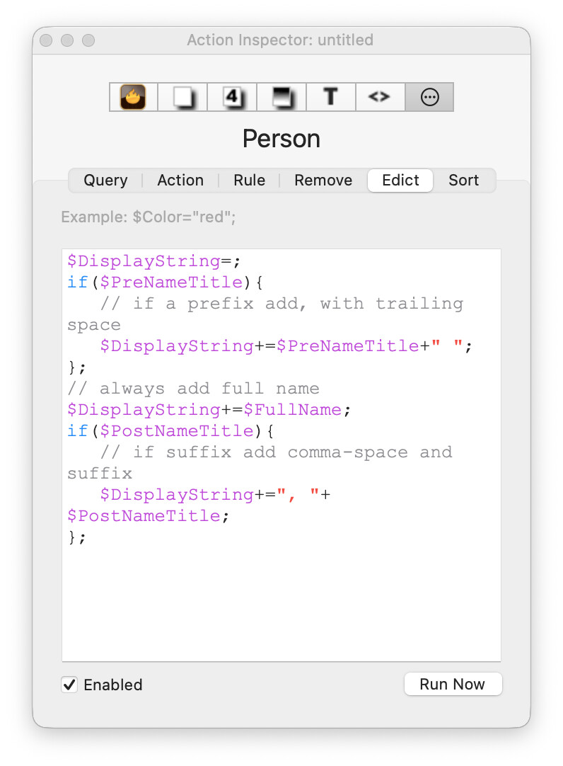

You could use this action in the prototype’s $Rule for quick testing, but for a real document $Edict seems a better choice:

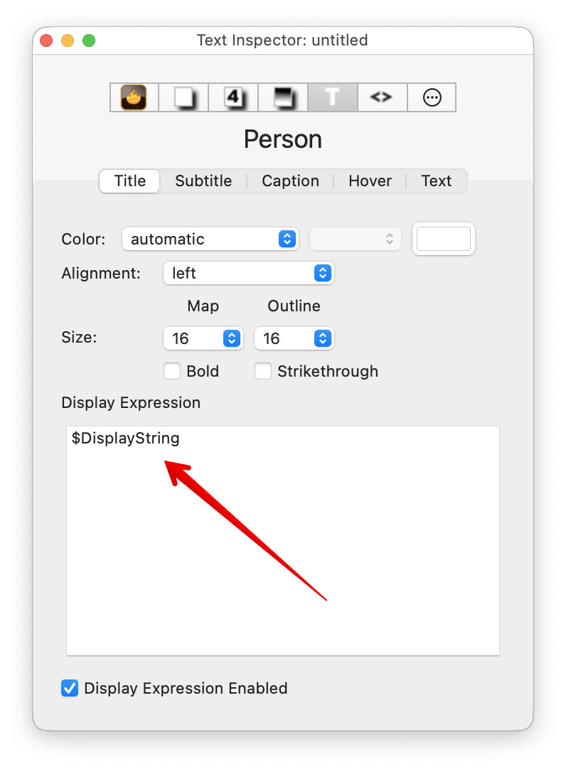

The code above populates a (new)s user attribute ‘DisplayString’. The value of the $DisplayExpression for prototype ‘Person’ now becomes:
$DisplayString

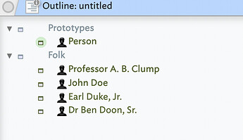

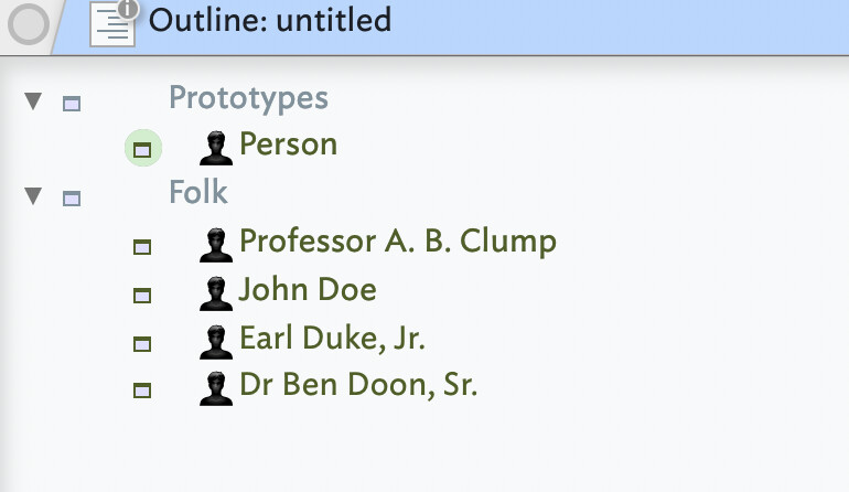

The result is like so:
