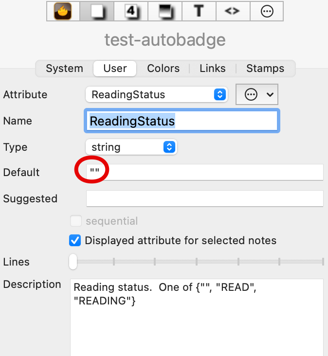

Thanks! The TBX is a real help, and I see the mystery name I misunderstood is actually a badge name (from the macOS icons set, this the dot-notation).
From the shared TBX, I’d say your note at $Path /Constants is a ‘config’ note. It proves the point that it doesn’t have to be called that. The convention arises as its an easy trachable term, but Tinderbox is very flexible about such things.
A few observations … firstly on your user attribute:
The “” (circled above) is not needed. If you don’t want a default value, leave the box empty.
Not strictly needed, but you could add READ;READING to the ‘Suggested’ value box. Doing this pre-populates the pop-up value list at the right end of Get info and Displayed Attributes tables. It also means you never have to re-key a value if it is correctly configured when typed in as a suggested value (note: the values ares a semicolon-delimited list) are initially entered.
:+1: Kudos for adding a description for your user attribute. It is so easy to leave that out and then weeks later be wondering about the fine detail of its purpose.
Rules run fast and all the time. Your prototype’s rule code is really better placed in an edict, noting that altering a Displayed Attribute value automatically triggers the note’s $Edict code. Also for both Rules and Edict’s it is a good idea to disable the rule/edict in the inspector:
That stops the code changing the prototype but the code is still inherited/run by notes using the prototype.
Does that help answer things?

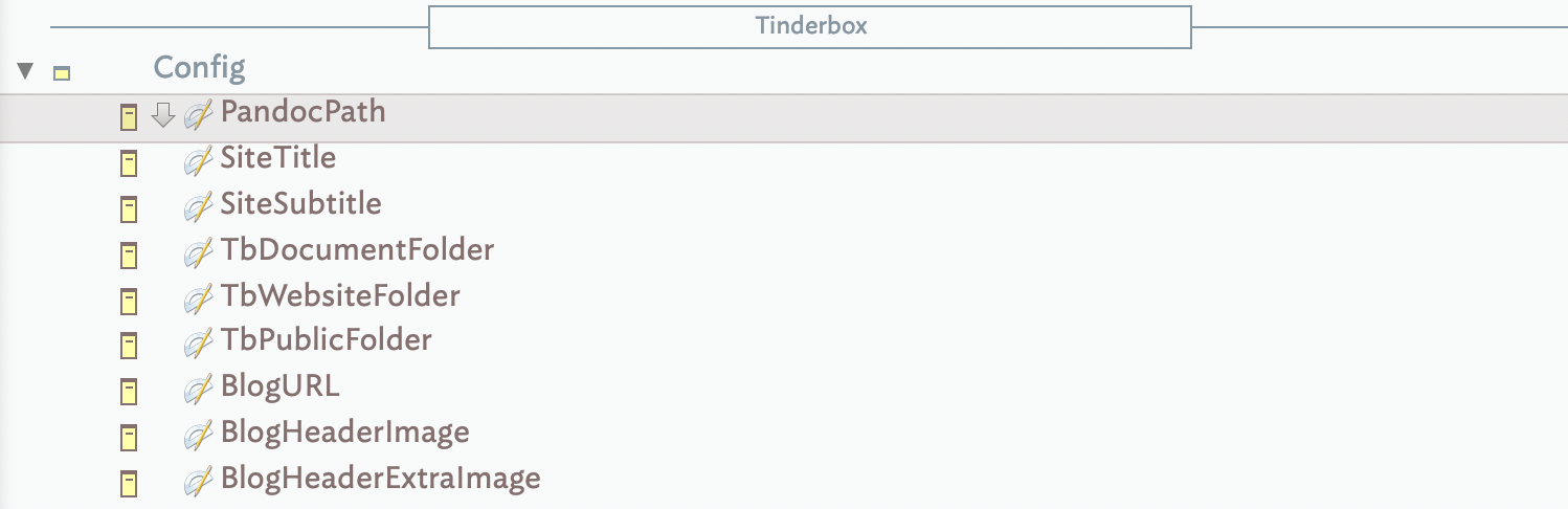

What’s a “config note”? It’s a note that sets attributes which are intended to be referenced by other notes. It’s a regular note that we’re giving a special function.
Why go to the trouble? One reason to consider using a config note is to avoid duplication, which should make things easier to modify later.
For example, if you have notes where you want to use a monospace font, you probably want to use the same font consistently throughout the document. You could set $NameFont on a number of different notes or prototypes. Or you could do this:
  1. make a new attribute MyMonoFont
  2. make a config note, e.g. at /Config
  3. set the value of MyMonoFont on the config note, e.g. set $MyMonoFont=IosevkaNFM on the config note
  4. add edicts like $NameFont=$MyMonoFont(/Config) to the notes that use the font
Now you can change the value of MyMonoFont on /Config and see the font change for all of those notes.

I think he answer is that ‘config note’ is a concept , note a defined thing. It simplest it is the notion of storing persistent variables (globals) general value (constants) in the attributes of a single note.
This note is normally at document root, for ease of access, but doesn’t have to be.
The note is also often calls ‘config’ or some variant of the name, but doesn’t have to be.
