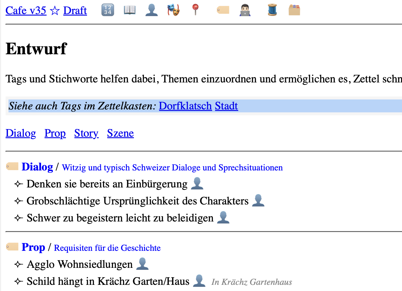

I collect notes representing central concepts/themes for my novel/project in Tinderbox. However, there may be other themes to which I only want/need to refer via a tag pointing to my Zettelkasten. I run the Zettelkasten on WordPress on my localhost. So Tinderbox HTML export and Zettelkasten WordPress work pretty well together.
If the ‘external’ tag notes have a consistent URL (except the actually tag value), then the method above will still work. I used an internal target partly as it makes it easy to show the method works.
If still stuck, the only thing we need (as we can’t) guess it is the local path to the zettelkastern tag. For instance, they could be .txt text files. a local URL would still work.

Since the meetup discussion took a slightly different (and fascinating) direction, I wanted to briefly share some context around my original question and how I personally use Tinderbox – perhaps it’s of interest to others here :o)
I use Tinderbox as both a Zettelkasten and workflow tool while writing my novels. Each book or project gets its own Tinderbox file, built on reused templates and structures. Typically, I organize each file with containers for Characters, Themes, Chapters, Locations, and sometimes a dedicated container for Tags from my Zettelkasten.
I collect material in two main ways:
  1. For central themes, I gather material directly in Tinderbox – Zettels, notes from readings, ideas, etc. Each thought gets its own note, which I link to scenes or themes as needed.
  2. For secondary themes, a simple keyword/tag often suffices. These point to entries in my larger Zettelkasten, which I manage locally in a self-hosted WordPress system. That’s why I chose the Tags attribute – it’s simple and flexible for lightweight referencing.
Tinderbox is almost always open on my computer. I do »Export HTML« several times a day, and during early story development, most of my work happens inside Tinderbox. The HTML version is especially useful when I’m away from my desk – traveling or on holiday – and want to review or reflect without needing my full setup.
