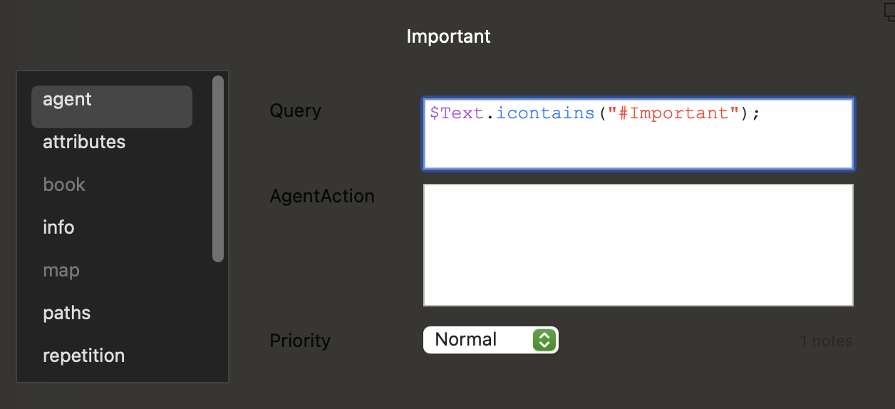

Hello,
In the screenshot attached (actually did not paste anything this time), the cursor is after the dot of “$Text.”
Regards,
Philippe
This looks like a macOS issue the I encounter from time to time in various apps. Clicking on/off the app to unset/reset app focus (not in-app re-focus) normally sorts the issue. The cause? I’ve no idea.
