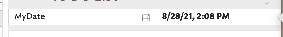

Date Format for Date Attributes?
Is there a way to change the format of the way a date is presented for a date attribute?
Specifically I want to show the year as four digits and not two for Start Date and End Date.
My expectation is that there a setting for changing the way a date presents.
Based on what?
I think this this due to the Apple US locale macOS defaults, from which Tinderbox inherits. On my UK-locale system, I see a 4-digit year:

Thanks Mark:
I didn’t think about the OS. When I looked at system preferences I see the option to define a short, medium and long form of the date but I don’t see a selection for something like preferred.
In general terms I would expect the OS to give the application control of the presentation of the date, if the date is an important parameter.
