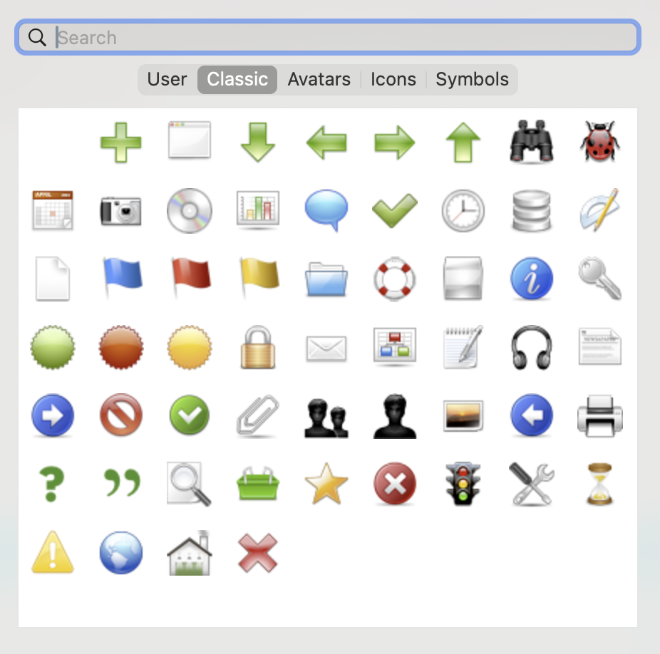

I can see how to add a badge (is this the correct term for what’s in this screenshot?)…
… to a note in both map and outline view. I cannot find at atbref how to delete the badge from the note
In the upper left-hand corner of the badge picker, you’ll see an empty space. That’s “no badge”.
Ahhh ![]()
Thank you.
In the article on Badges it links to the more detailed article on the Badge pop-up picker and states:
Clicking the first (blank) tile in any set resets the Badge to the default inherited state.
Which is to have no badge—if unsure see here.
