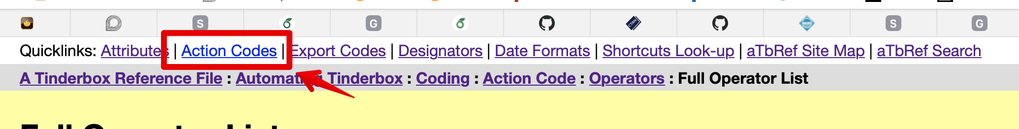

Where to look if lost again on the = vs == meaning?
My suggestion is the easiest pace to find and see the different operators is in aTbRef’s full operator listing. Happily for just such quick look-up reasons, the page is also a quick link at top and bottom of every aTbRref page—see below:

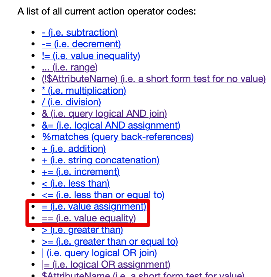

In the list, both the operators list together (digital sorting is not always so kind!):
In this sort of case, that list may be enough to answer the “which operator?” question or of course you can click through to a full description.
