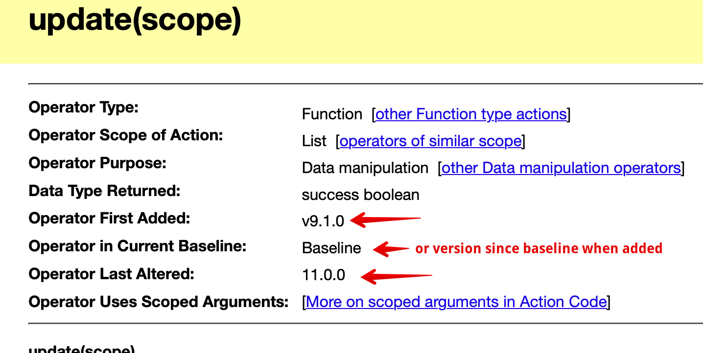

It’s fair to note that operators like changed() (v9.6.0), and update() (v9.1.0) are fairly recent in Tinderbox’s 25 year life. They also reflect the increasing complexity of code (action script, command line, AppleScript, etc) that a small section of users now employ. IIRC, update() derived from discussion of ensuring the results of actions were properly reflected before the app moved on to other tasks. Likewise show() (v9.5.2) arose because some—myself included—were running large/complex actions on big selections and needed a way to know when.

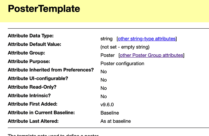

Note: most aTbRef operator and system attribute listings indicate what a feature was first added (see grab below. I recently added this info specifically to try and help longtime but occasional/light users to see if the reason they were unaware of a feature is because it was added since they last dived into the documentation. More too that manny features never get raised and discussed in the forum. so no entry there is not proof of no such feature. For aTbref today the search page (in the link bar at head/foot of every page) is a good start. The app command Bar is fie but it’s only at best updated to the website as at release.
I edit aTbRef’s content near daily. Thus, direct search of the website is I’d suggest always the best option for finding content there.
For clarity: there is no advertising, I bear the full costs of traffic to the website. It is on my (virtual) webserver.
aTbRef listings showing when a feature was added/latered:
