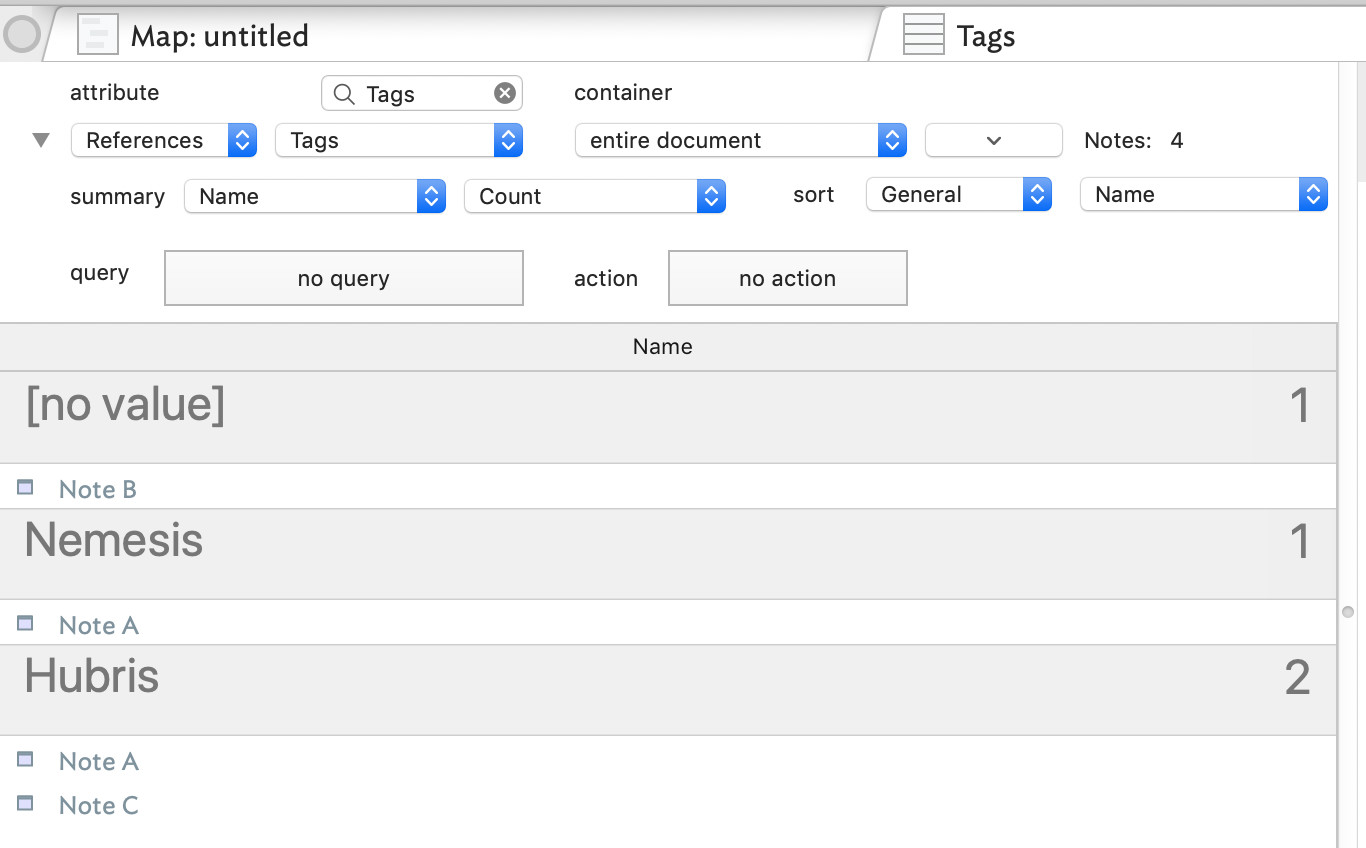

So, take the attached demo: tag-check.tbx (149.5 KB)
Note A has Tags ‘Nemesis’ and ‘Hubris’. Note B has no tags and Not C has ‘Hubris’.
Note that ‘Note A’ is listed twice as it has two tags. To lose that ‘[no value]’ category, we’ll add an agent with the query:
$Tags
This is short form of the same query I listed above— i.e. only match those notes that has a value for the Tags attribute. In the demo I’ve called the query “Must have tags”. Note how now only two notes are listed. Note B is omitted as it has no tags:
