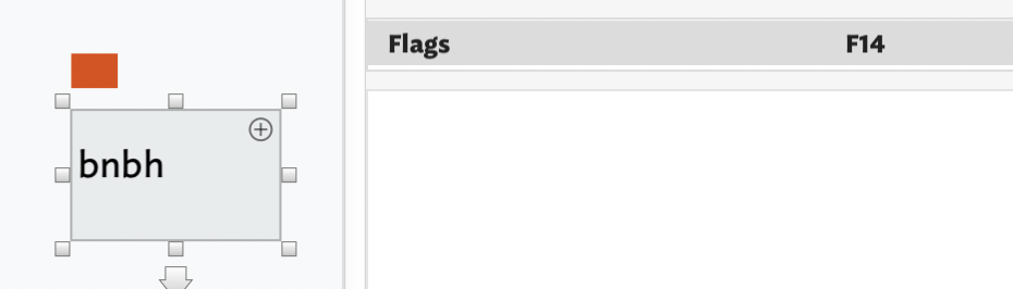

Missing from this is that a colour is always needed. So if I set a value of F14 with no other characters, ttbx assumes I want to set the named colour ‘F14’. As this colour is not defined, we get the ‘undefined colour’ value, an organey-red:

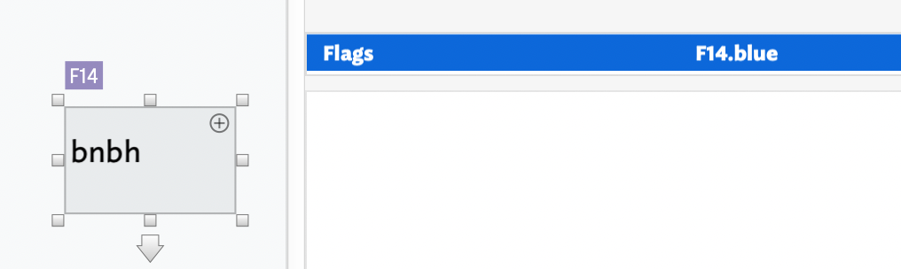

If I add a known named colour after a dot, we get white text on a falg of that colour:

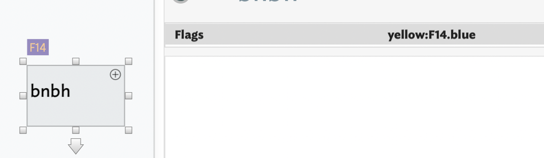

If I prefix a colour name and colon, e.g. yellow:F14.blue:

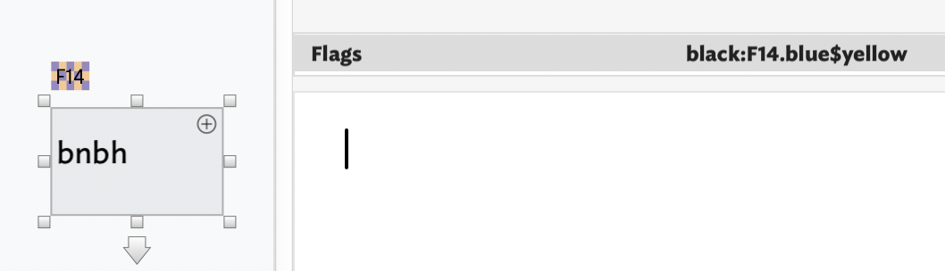

That syntax might seem odd, but it allows us to chain other colour patterns on the end, thus black:F14.blue$yellow:

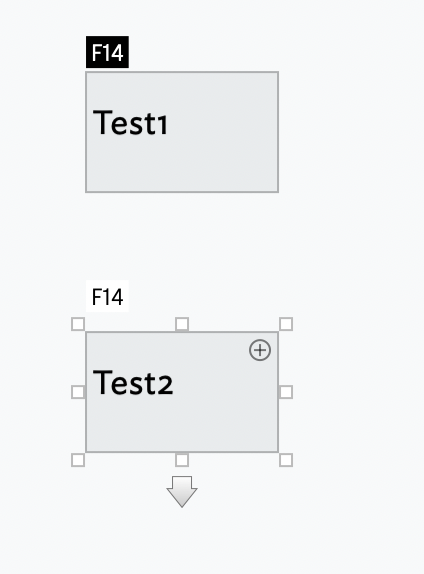

I used stamps. For ‘Text 1’:
$MyString = "F14";
$MyColor = "black";
$Flags=($MyString+"."+$MyColor);
For ‘Text 2’:
var:string vText = $MyString;
var:string vColor = $MyColor;
var:string vTextColor = "black";
$Flags=(vTextColor+":"+vText+"."+vColor);
Note: you want the string value of colours (either a literal name or hex code). I used enclosing parens to ensure the string is fully concatenated before it is passed to $Flags.
So yes. I’ve not tried an function but the latter is more of a wrapper to the code setting $Flags and that seems to accept dynamic values, albeit first assembled as single string before being passed to the $Flags atttribute.
