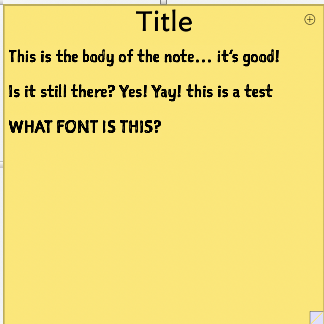

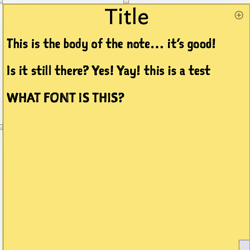

Somewhere along the line I impacted the font of the new notes I create in this one container. An original note looks like this:
When I later returned and created a new note, it looks like this:
… hence the “WHAT FONT IS THIS?” on the original note.
They may in fact be the same font in just a different ‘style’.

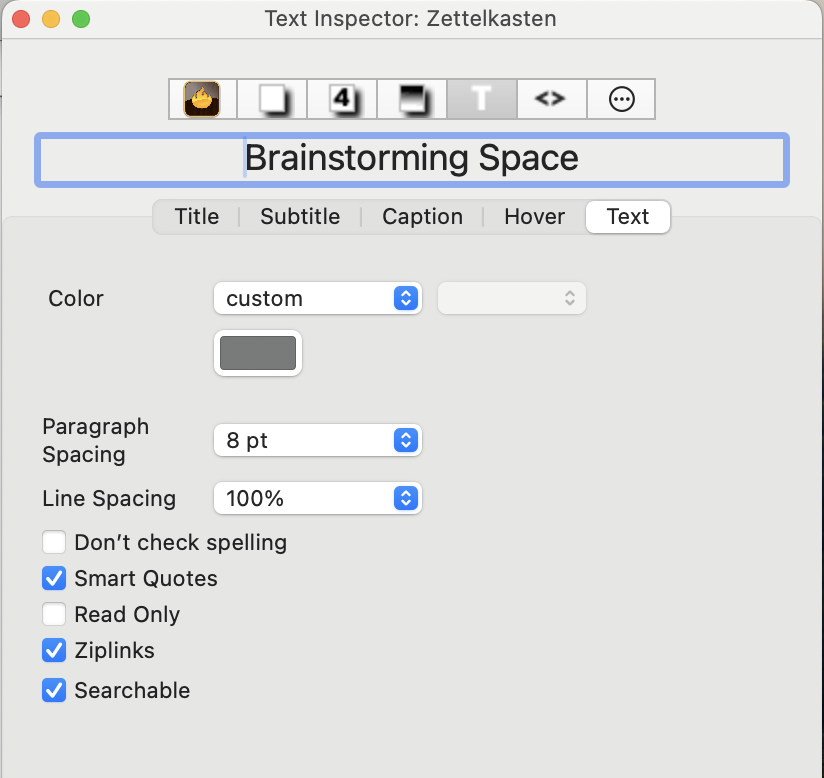

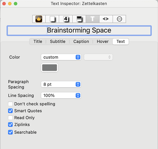

I am trying to find my way back to whatever I did to get the first style of note seen here… and I’m a bit lost. I believe I want the container inspector as I want all notes in this container to be of the same style. But when I am in the container inspector I find no way to edit the text in the ways I need to. All I find is this:
Please advise. Thank you.

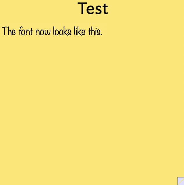

If you select the note shown in the last screen grab above, open the Get Info/attributes pop-over and type in the search box TextFont and hit return, the attribute $TextFont will be selected for you. My guess is its value with be Noteworthy-Light (possible Noteworthy-Bold.
If so, to fix this, click the ‘A’ button next to the row label ‘TextFont’ and in the Fonts palette select font ‘Sketchnote Square’. Doing so will set the note’s $TextFont value to SketchnoteSquare. OK so far, but the note’s text isn’t changed by this. You need to select all $Text in the text area and then use menu FormatStyleStandard Font , or click ⌘+⌥+⌃+T. This set the text to use the $TextFont font and not the last-used font. This is because all $Text is styled so retains the font designated when it was first corrected (in this case with the incorrect user choice of font).
