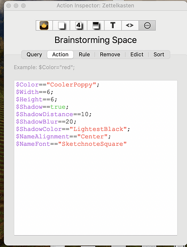

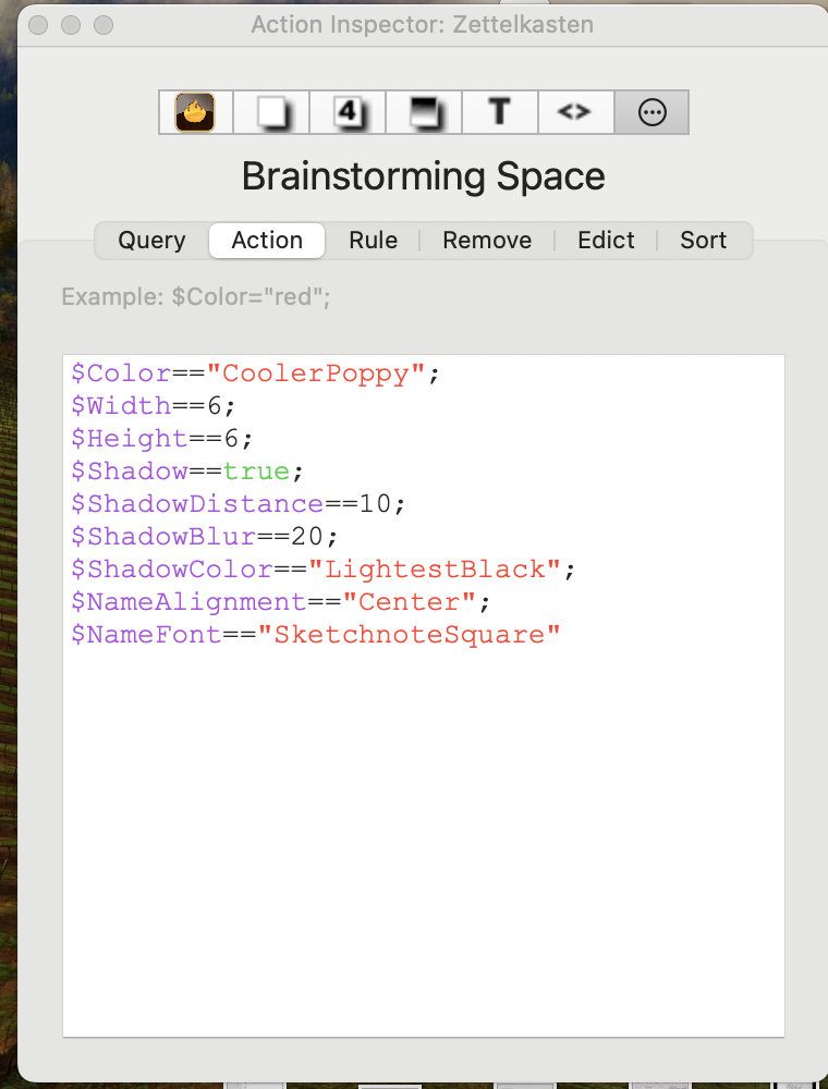

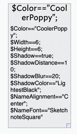

I am trying to format the appearance of all notes in a container. I followed instructions online made using Tinderbox 7 (updated formatting that was different than what I had used recently creating agents, for ex. used == instead of =). I followed the install instructions and it didn’t work.
  1. are my instructions correct?
  1. instead of getting the design applied, I got this:
Please advise. TIA

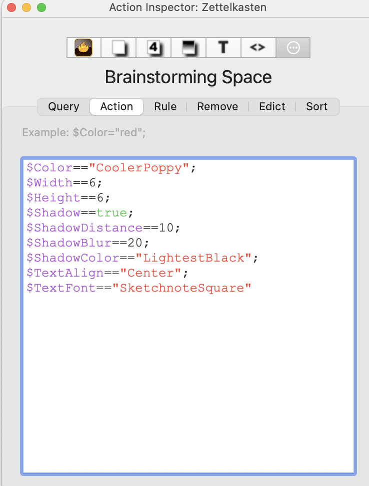

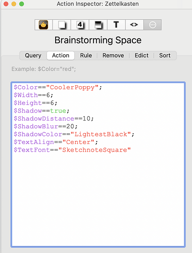

I spent some time comparing atbref System Attribute List with the a/n list and saw some new formatting. I changed some things and now have this:
It still didn’t work.
Quick fix: change all the == to =.
Explanation
Basically, you only use == is you’re testing whether a value is equal to another value. So:
if ($Color=="CoolerPoppy") {do something}
What you need here is to assign a value to an attribute, and for that you only use = So to change the colour to red, you’d use
$Color = "CoolerPoppy"
Or, so to put it all together, to test whether the colour is now red, and if it is, change it to CoolerPoppy, you do this:
if($Color=="red") {$Color="CoolerPoppy")
Hope this helps to make the difference clear.

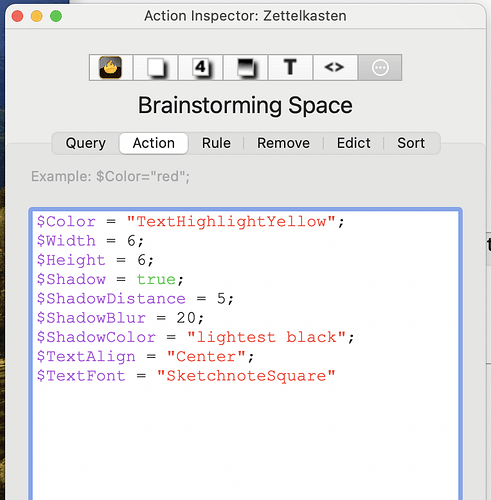

OK. Made some changes and now have this:
I am entering the color names as I find them on the Chart of Tinderbox’s Defined Colors (some have capitals, some not; some have spaces, some not). When I run a test, I get this:
… but the color name I have entered is actually this:
Tried a few times to sort it out. TIA
There is probably not defined color named “TextHighlightYellow”.
You likely want $Color = $TextHighlightYellow; which sets the color of the note to whatever color is stored in that note’s yellow highlighting color. If you wanted the symbolic color named “yellow”, you’d say $Color="yellow";. You could also say you wants $Color="#FFFF00";, which sets the color to turn on all the red and green pixels, but none of the blue pixels.
If it helps, when I am entering data that needs “==” and/or “=” I mentally say to myself “is equal to” for “==”. So, if I want to test whether A is equal to B, I write “A == B” but in my head I am saying “A is equal to B”. That works for me, but YMMV.
An easy way to check if the current TBX document has a (system or user) defined colour named TextHighlightYellow us to open the Colors Inspector. On that open the Color pop-up menu. On that menu all known defined colours are listed with their name and a small colour-chip of its current colour. Numerical ‘names’ list first, then textual names (i.e. ‘0’-‘9’ then ‘black’, etc.). The system and user-defined colours are listed by sort order and their differing provence is not indicated (i.e. system vs. user).
Separately, the default value of the system attribute $TextHighlightYellow is #FFFF00.

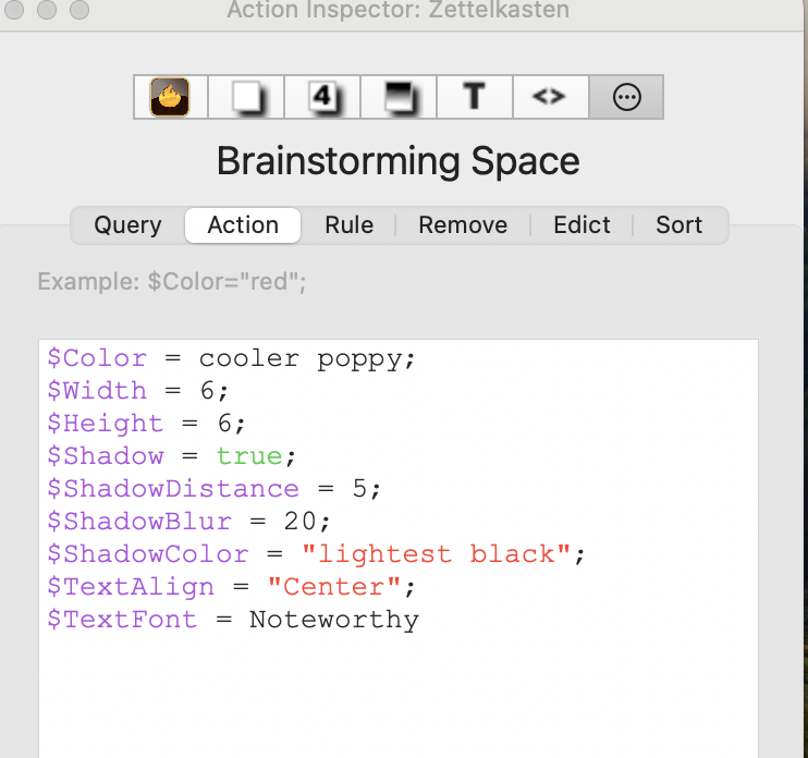

I am now trying to change the note’s font. Using info and links in atbref.com I chose the Mac font Noteworthy. Opening the inspector from the container (which I did to successfully work on the color) I have tried two things, neither of which are having an effect:
$TextFont = “Noteworthy”
$TextFont = Noteworthy
Not sure what I am missing.
TIA

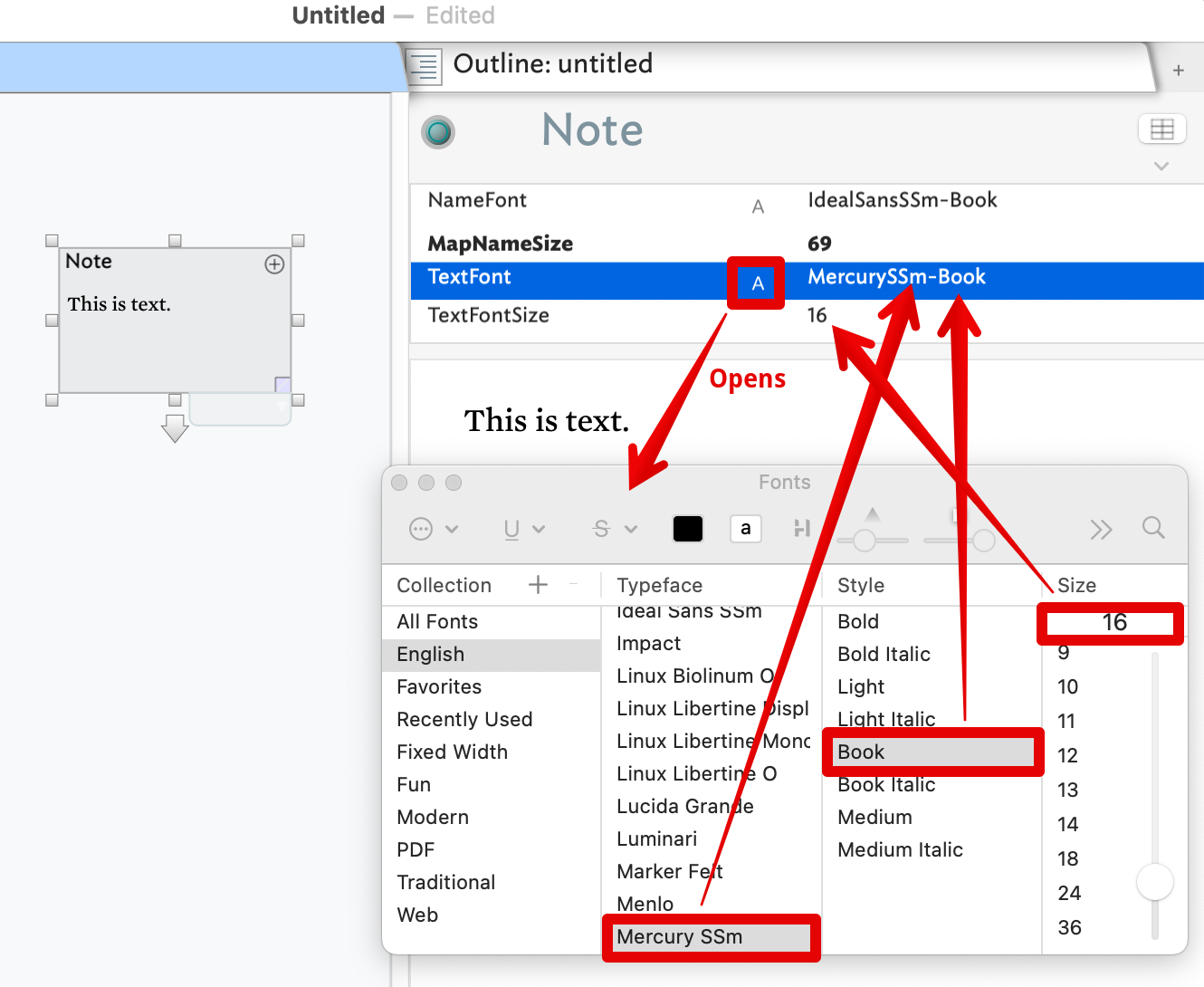

If you set $TextFont in a container’s OnAdd (e.g. as you showed up thread), this will set the $TextFont for all newly-created child notes. If you promote/demote existing children the OnAdd will update the $TextFont value for those for those notes but it will not affect existing $Text in the notes. See a description of $TextFont for why there is this difference. for notes with pre-existing text.
If you’ve done the above correctly and the font used in the $Text of a new child note isn’t as expected, add $TextFont as a Displayed Attribute and see if the value set is as expected. If not click the ‘A’ symbol to open the macOS Fonts palette and see is the correct font is selected. If not, you may not be using the correct names for this process. Font names are a bit odd as under the hood they often have more complex versions of their general descriptive name. For example:
Clicking the ‘A’ opens the Fonts palette. The highlighted places in the palette are what set $TextFont. The same palette may be used to set $TextFontSize but isn’t really needed as the value is just a point size number—here, 16 (point).
Notice above how the default $Text font ‘Mercury SSM’ is set in $TextFont as Mercury SSM-Book. this is the sort of minor difference I allude to above. In many cases the value you’d intuitively set is the same as that set via the palette, this is just an example of how the two can differ. Why this is so is historical baggage and not a rabbit hole to explore here. It just is how things work.
Documentation worth a skim read (and follow relevant links within):
