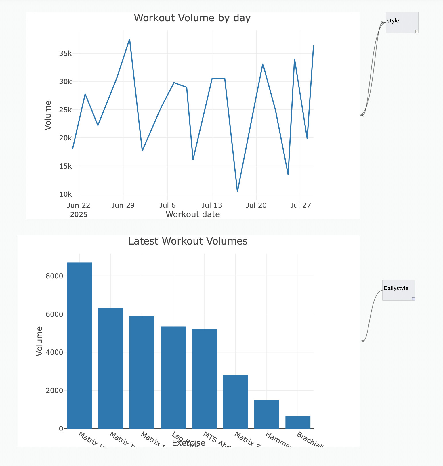

Thanks to the valuable suggestions from @eastgate and @mwra and others, I’ve improved my Gym Workout file and I’m including it here.
Workout Repcount processing.tbx (570.3 KB)
I’m most proud of being able to implement Posters in this file, and that process has taught me a lot.
There are two Posters implemented:
  1. “Agt- Workout data” pulls all of the workout volumes (defined as the aggregate of weight * reps for all exercises in a workout) that are included in the /Workouts container, and displays them as a timeline chart using Plotly.
  2. “Latest Workout” identifies the most recent workout from /Workouts and creates a vertical bar chart of volumes by exercise, again using Plotly.
Posters really are a straightforward feature of a note–once you get the hang of it. For me, that meant studying the demo template provided in this Forum and learning how to use Tinderbox to feed note attributes to a visualization product such as Plotly.
As always, comments and suggestions welcome!

The posters are on the root level map, but for anyone wondering where they are, you’ll need to scroll down and then you will see:
