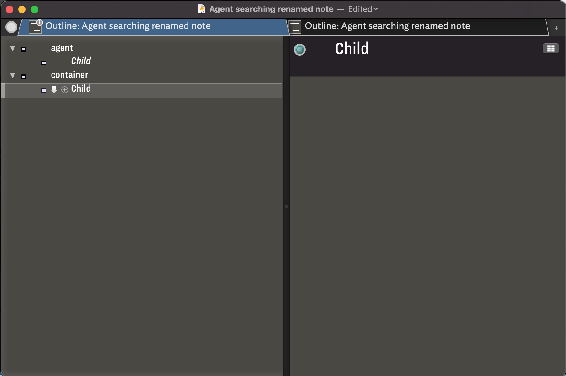

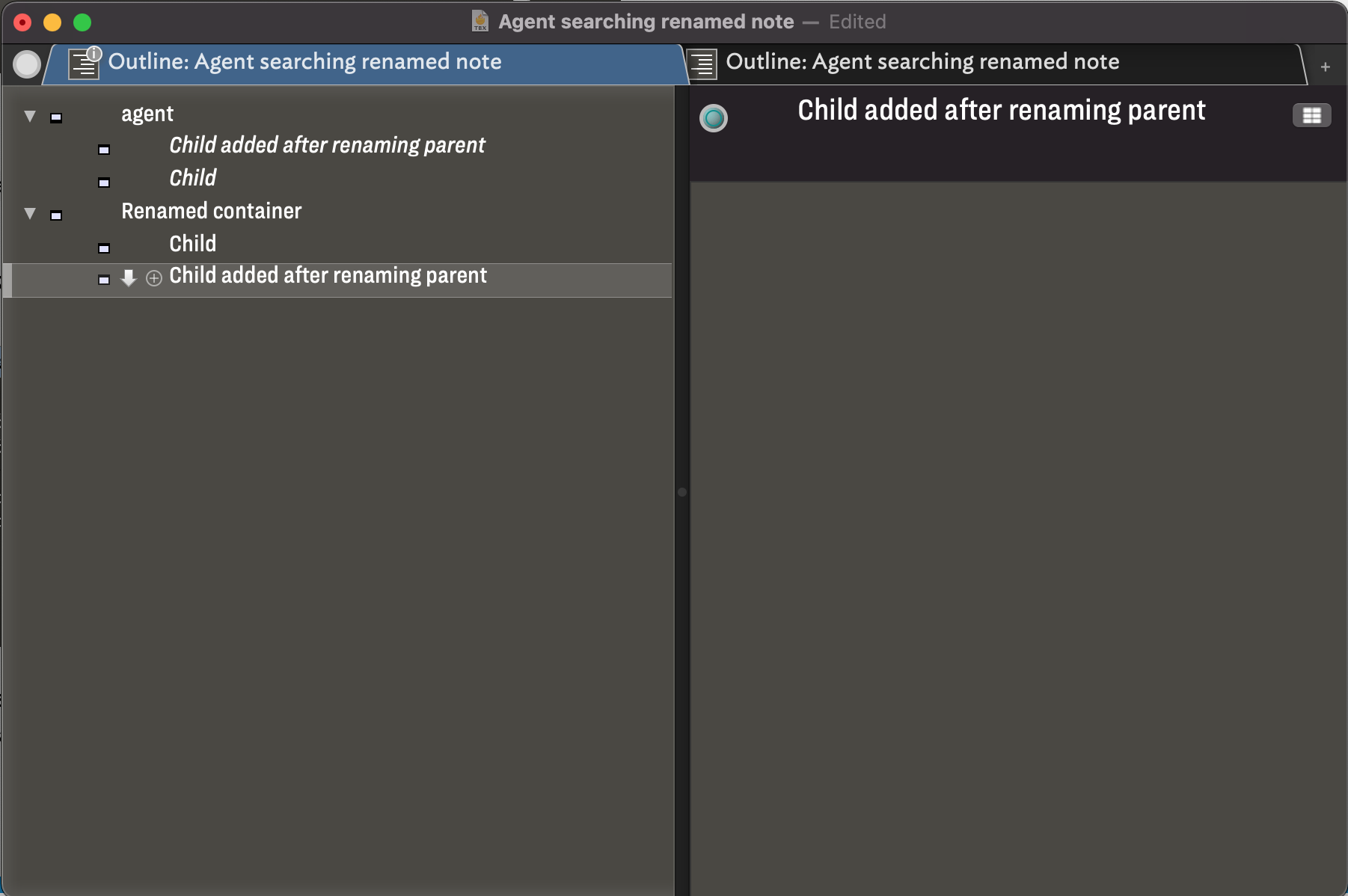

In a simple test document, I create a note “container” and then add a child “child”.
A simple agent has a query that returns the children of “container”.
If I rename “container” to “renamed container”, the agent still behaves correctly, updating even when I add “sibling” and “third child” to “renamed container”.
But the agent query still refers to the target note as “container”.
I’m glad I can’t carelessly break my agents, but I’m finding it a little hard to trace what older agents are querying.
How resilient is this behavior? Is there any way to tell which agents are querying obsolete names? Is there any way to update them?

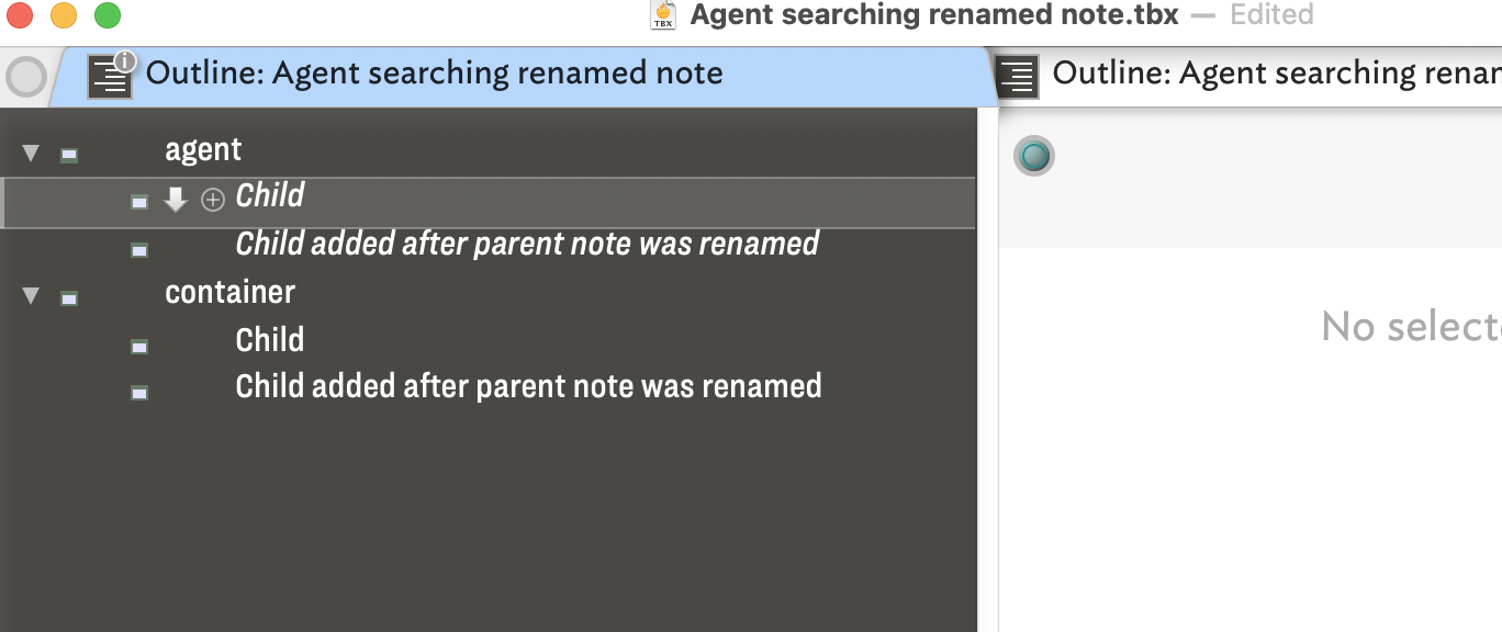

In v10.1.2 I see:
The query is:
inside(container)
and the agent matches nothing as there is no object with the name container. If I rename the container back to the original $Name of container:
So all works as expected. Did you perhaps turn your agent off (so it wasn’t updating)? If the latter the existing aliases remain (as the query is not run).

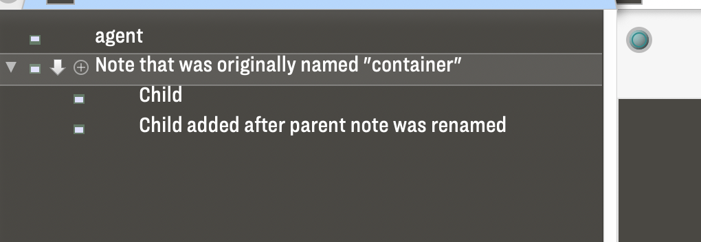

I’m including screenshots, to better illustrate.

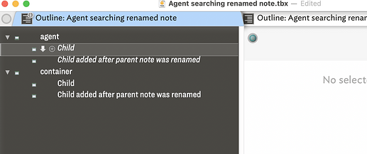

  1. original configuration:

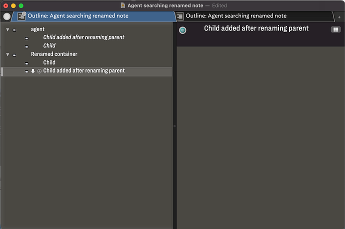

  2. renamed container:

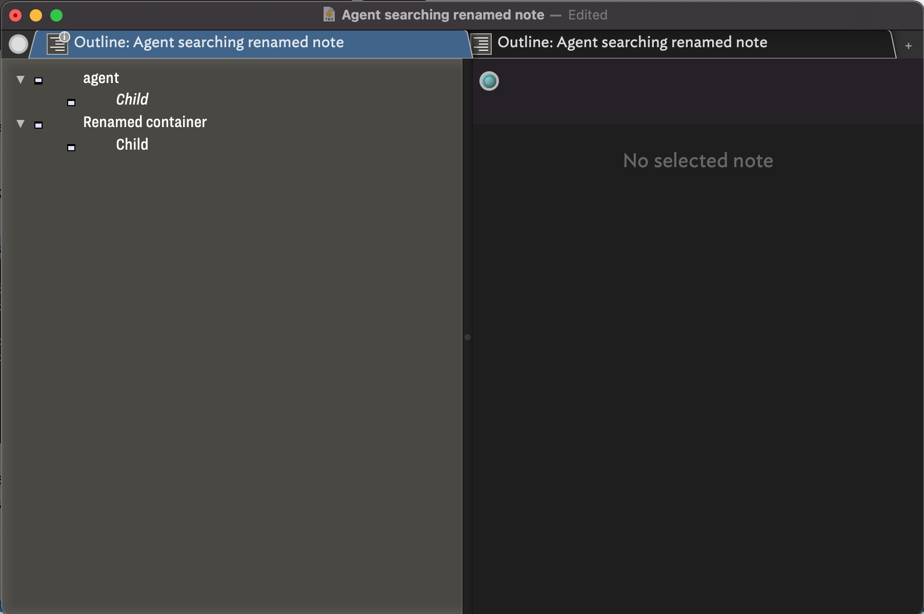

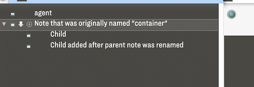

  3. added a child in container and waited for the agent to update:
    ^^^^^This is unexpected. (Isn’t it?)

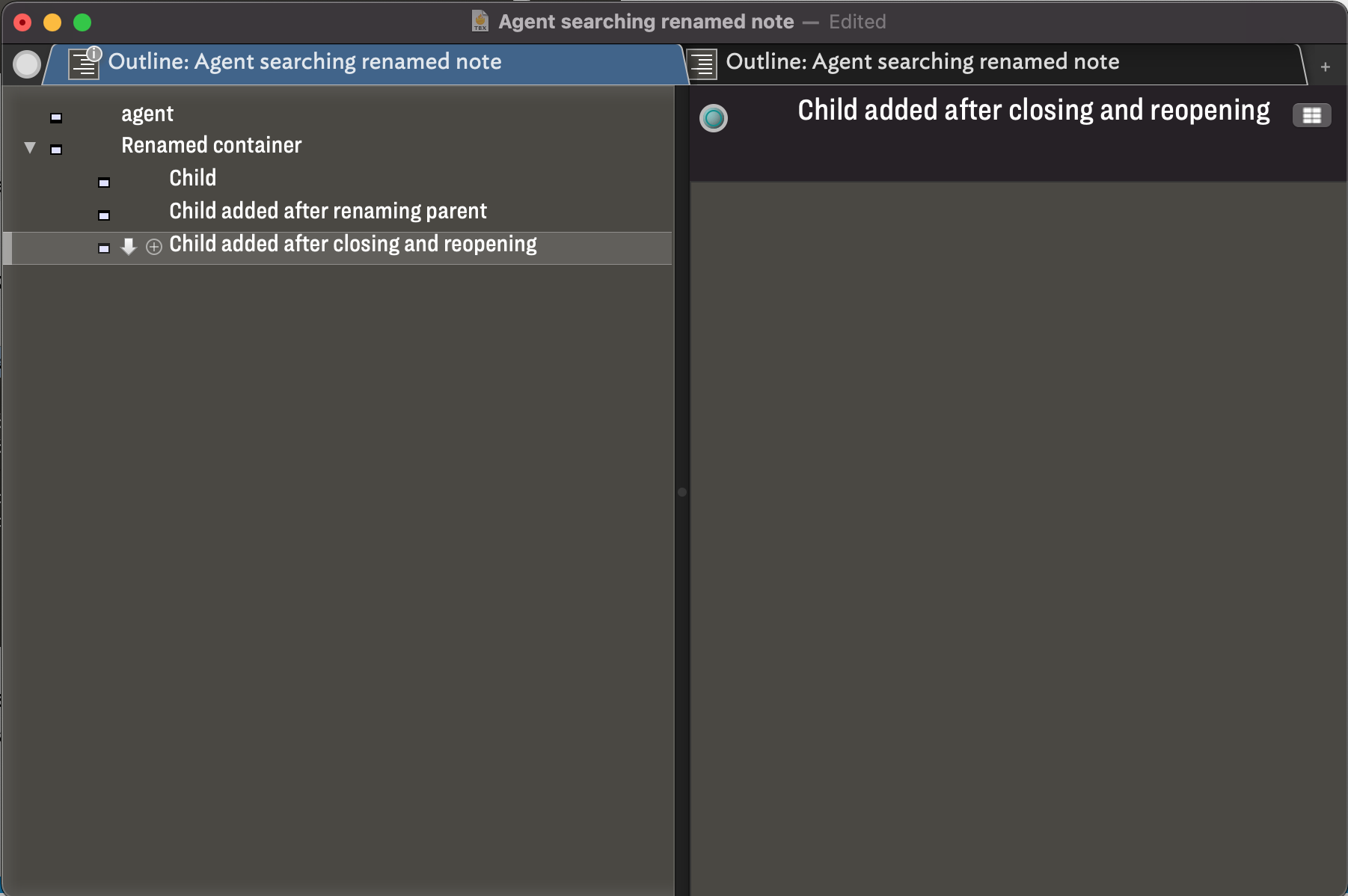

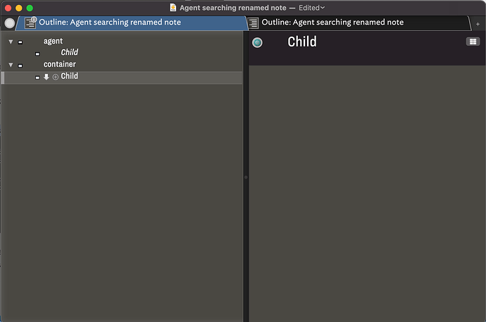

  4. closed and reopened:
    This is back to the expected behavior. (Unfortunately, this is the state you’ll get if you download the demo tbx.)

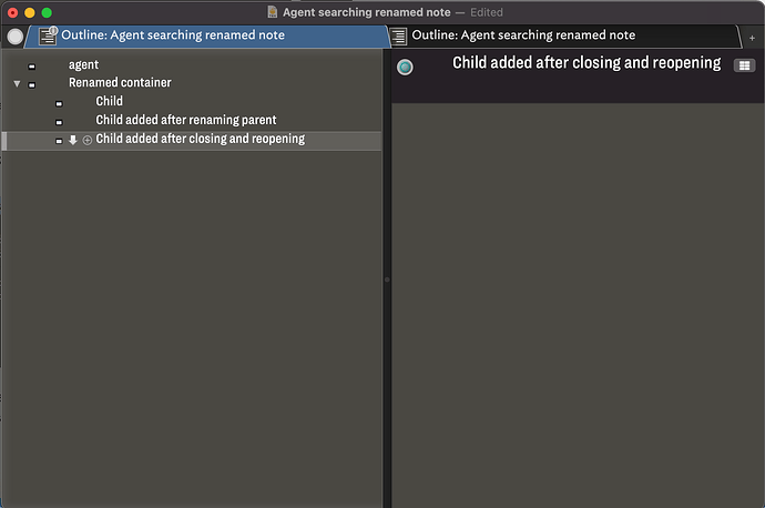

I get the impression this is an “unintended feature” arising from the way Tinderbox agents are optimized under the hood, and it’s not something we should rely on.
