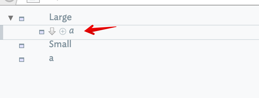

Setting $Container works for me:
$Container = "Large";

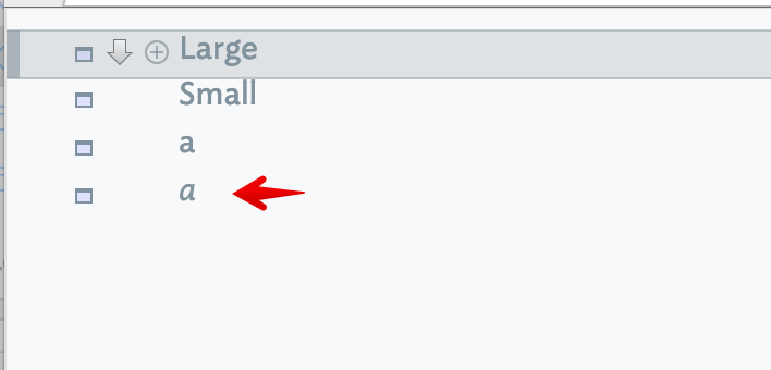

Here we have ‘a’ and an alias, created manually as per the OP’s post:
I stamp the alias with the above stamp:
Given this, the most likely cause(s) of failure:
  • if not selecting/stamping the alias directly, you may actually not be acting on the object you assume you are. If needing to work via action(rather than the UI) consider using find(). This is because find()—unlike agent queries—doesn’t dedupe matches/weed aliases. Of course you’ll still have to pick the right alias, if several.
  • the target container may be a duplicate (name or path). Try again using an ID or IDString to see if that works as the latter don’t allow such ambiguities. Bear in mind that where name/path ambiguity exists, Tinderbox always picks the first match by Outline Order. Only using IDs routes around that as an ID (even for laiases) is unique.
