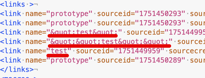

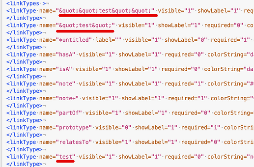

You could use linkTo() and UnlinkTo() to delete make new links of the good link type and delete links of the bad type, then check explicitly for any use of the bad type. But, with 4k ‘bad’ links using BBEDit or similar is faster cleaner. Here is link data from a small TBX where the above bug has cloned link type text
to "test"
and ""test""

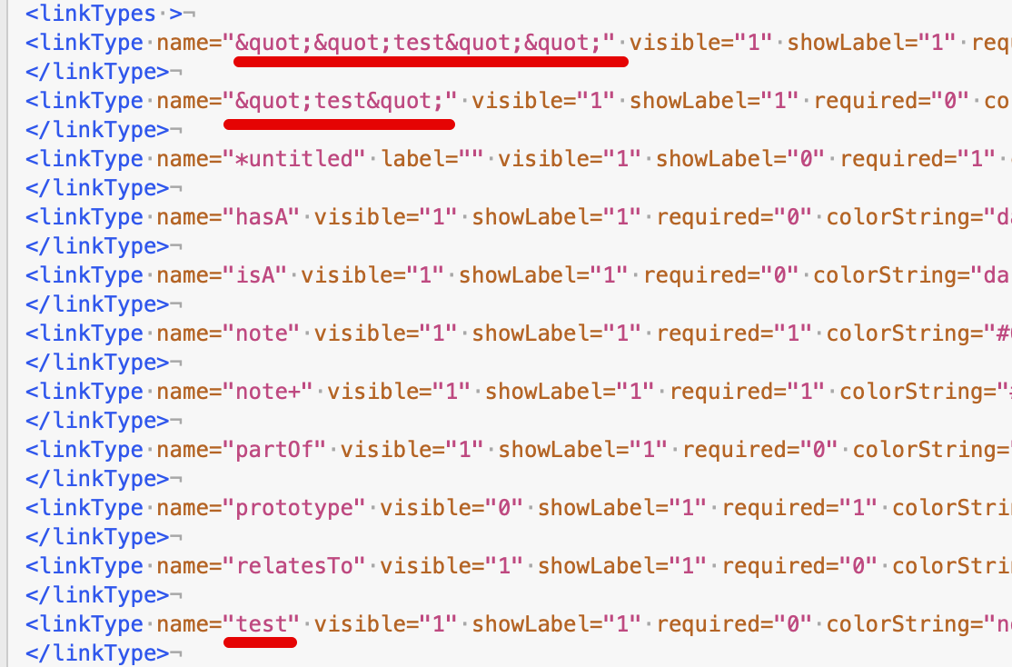

In the above there is a single link each of the ‘correct’ test’ and each of the quote-enclosed versions. Here is the link types listing for the same doc:

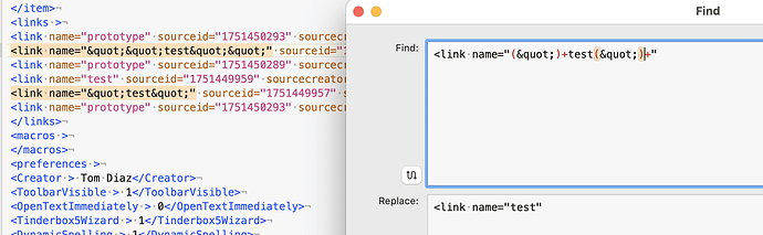

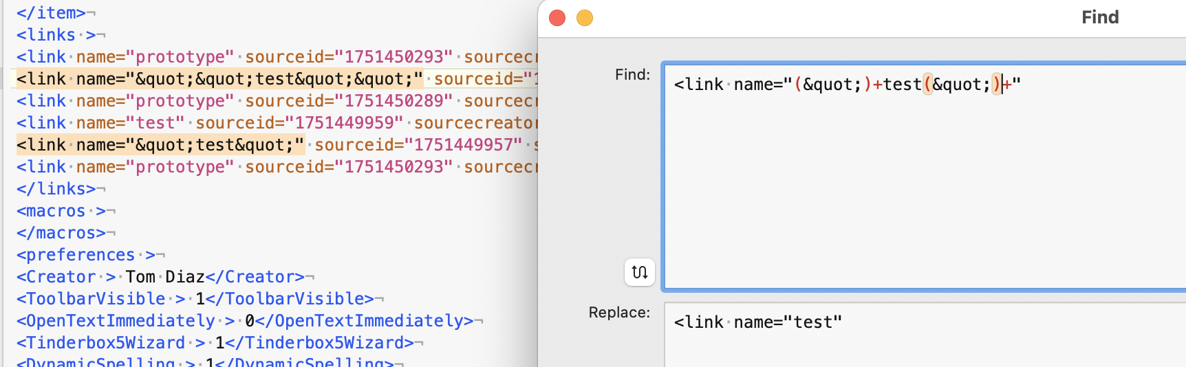

So, first we fix the links. We use Find & Replace in BBEdit (you can use a similar tool):
Note the ‘find’ regex matches ‘bad’ type variants using one or two sets of enclosing straight double quotes. It the bug had run away such that you had types like """""""test"""""""
the regex would match those two as (")+
matches one or more consecutive instances of string "+
. Make sure you replace the ‘bad’ data both before and after the link type name.

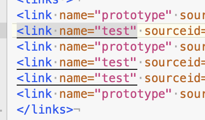

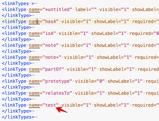

After running the replace is run, notice on;y the correct test
link type is used:

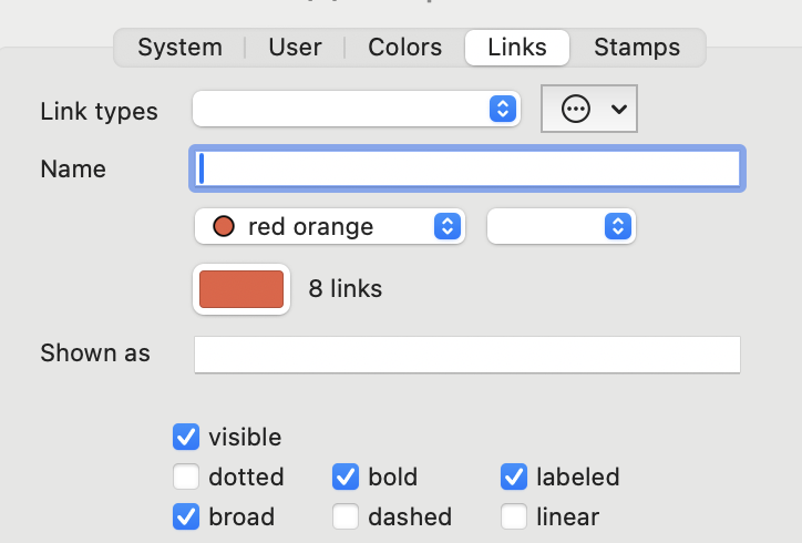

In the Link type inspector select the ‘bad’ link types like "test"

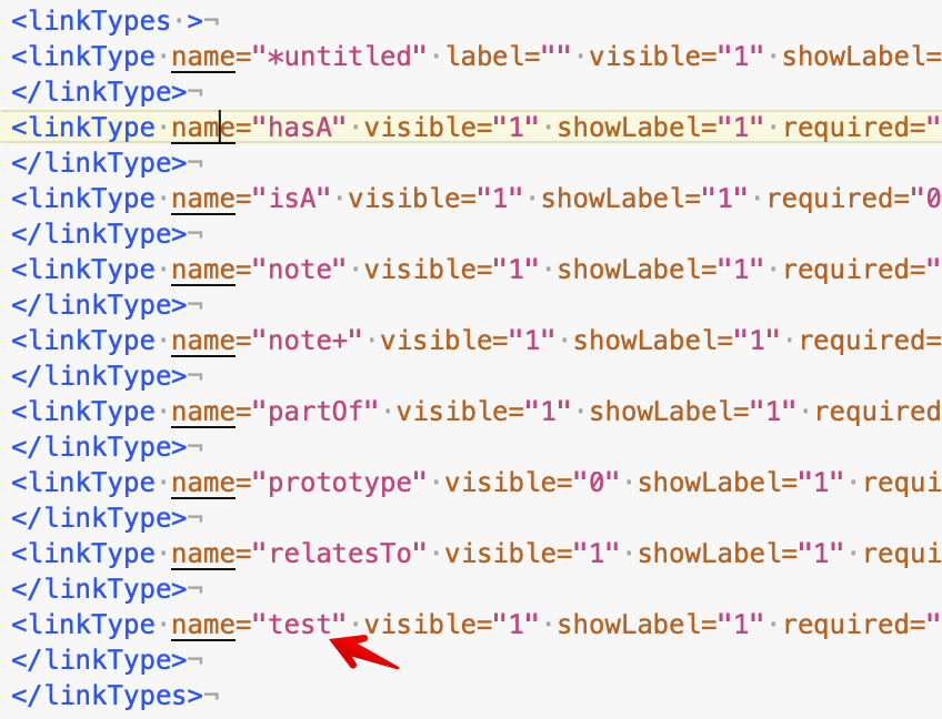

and delete them as no links now use that link types. So compared the grab above, the link type listing the TBX’s XML will look like:
Save the edited TBX, close, re-opening in Tinderbox and check all looks OK.
