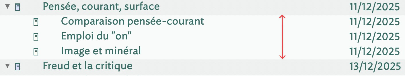

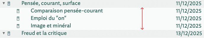

Hi! I’m trying to figure out how to implement this rule in the inspector: if a note becomes a container and contains more than one note, then its background should be a certain color. Currently, I’m doing this by manually setting the OutlineBackgroundColor attribute to #cad1ce as follows:
