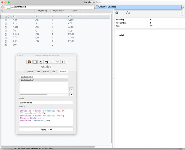

In this screenshot, I’ve used $Name for $RefCode and $Text for $NewCode, and I’ve put the action code into a stamp, but hopefully you can see how it works. Obviously, you could use the same code in the Action Code of an agent or make it into a function as well.

I just noticed, the above line of code creates an error, illustrated in your image of the test, in that both ‘CD9’ and ‘CD99’ end up as CD09 whereas the latter input logically ought to be CD99

The problem is your initial code extracts List-type data, e.g. from ‘CD98’ you extract 9;8. But as you store the list in a Number-type $MyNumber, the latter can only store a single number. So it takes only the first item in the list, i.e. just 9 and thus the output error arises in the revised code.
By comparison, the revised regex extracts a single number 98 from ‘CD98’ and so the overall code returns CD98.
