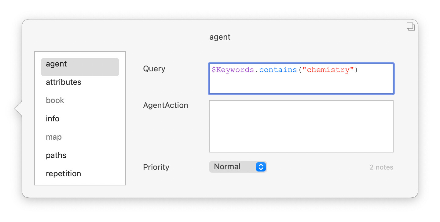

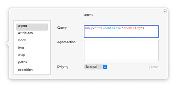

Great. Don’t worry unduly about how the quotes got in that form, it happens. To illustrate for later readers how action code syntax colouring helps, here is what you’d expect, i.e. after I fixed the above TBX, as shown in Get Info/agent:

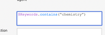

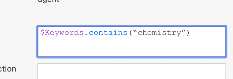

The purple text indicates ‘Keywords’ is detected as an attribute (user or system) recognised in this document. The blue text indicates ‘.contains’ is recognised as a valid operator. The red text in indicates a a string of text between a pair of straight double quotes. If I had used straight single quotes (also allowable here) the same text would instead be orange. But, see what happens with curly quotes:
No colouring of the match string! That was what I spotted last night. The syntax colouring is also seen in any Inspector input box expecting action code and in notes using the built-in Action prototype. Also be aware of the built-in Code prototype doesn’t apply action code syntax colouring but does use a monospace font, turn off smart quotes, etc.—see the linked article fro the settings changes it makes. The Code prototype can be good for notes where you’d like to park some code that should be run but without the code getting damaged by quote-type-conversion. Importantly add the prototype before pasting code into the note’s $Text.
