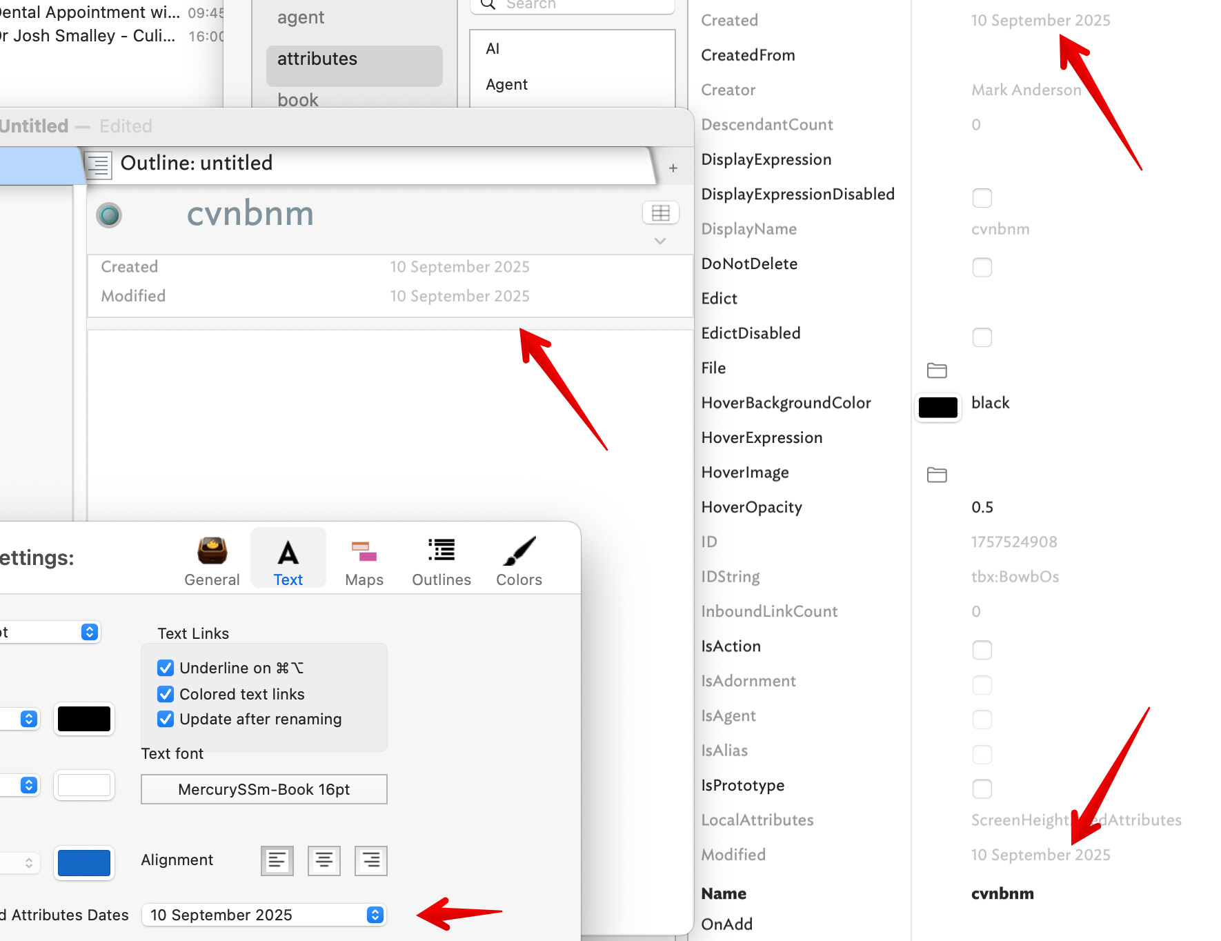

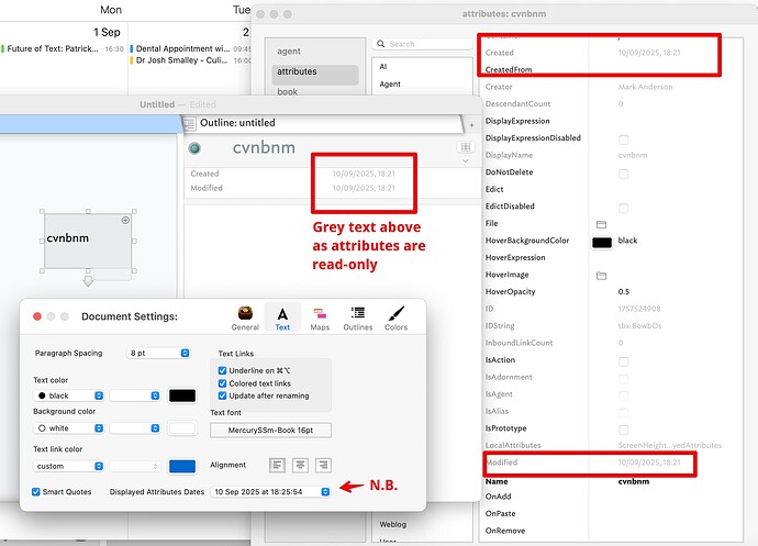

A different angle is the display inside Tinderbox, which means either of two places: Displayed Attributes tables or the attributes sub-pane of the Get Info pop-over/dialog. The default is thus:

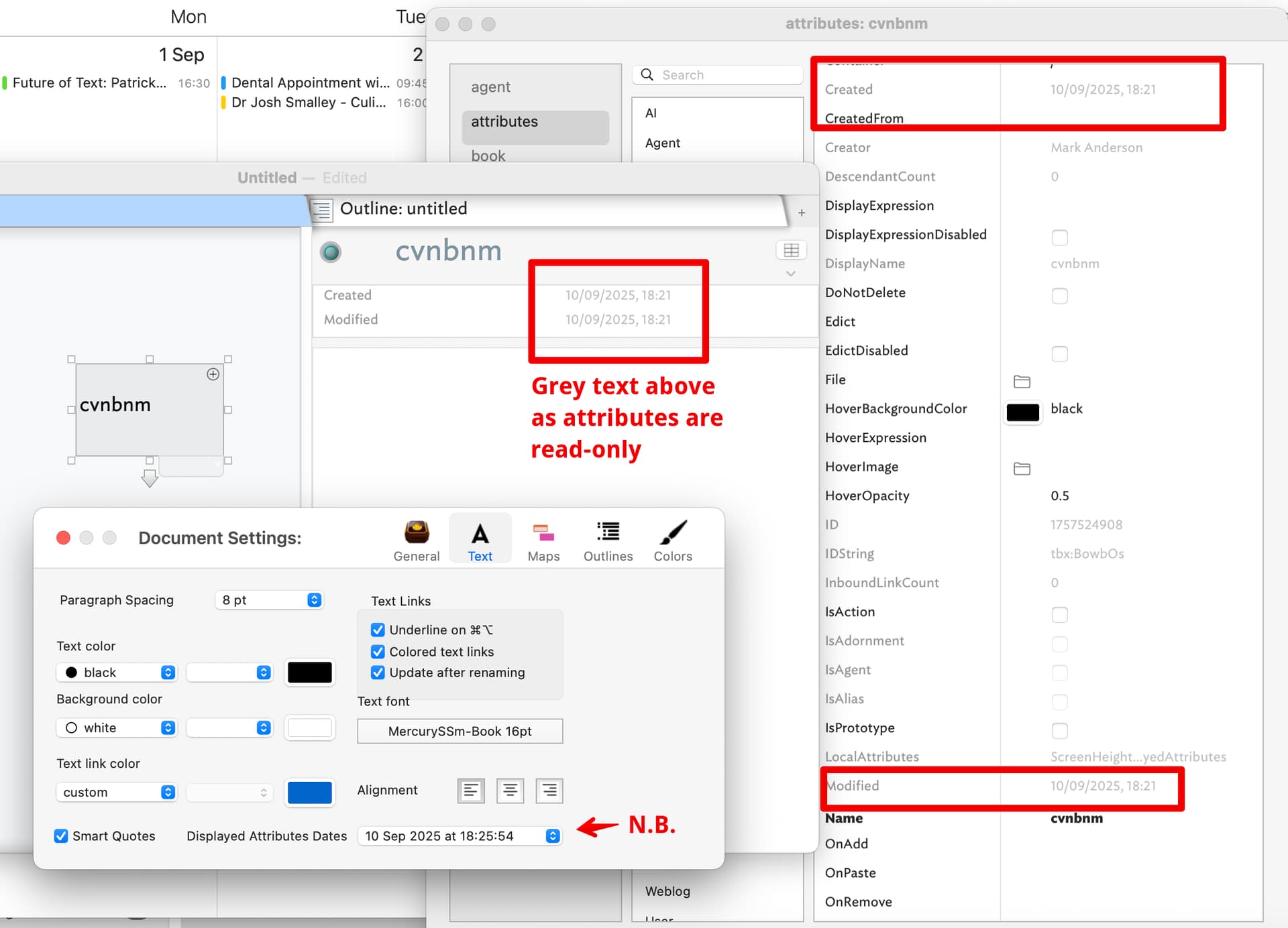

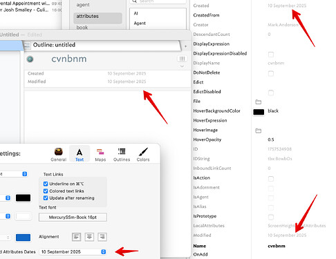

Note the Doc setting label says ‘Displayed Attributes’ but the format is used for Get Info as well. Here we are seeing $Created and $Modified but the same format holds for all Date-type attributes. The format shown can be altered, but not per-attribute. So, if we change the document settings for displayed (attribute) Dates:
Notice the change?

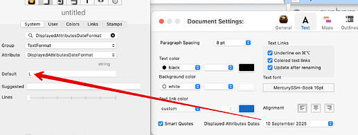

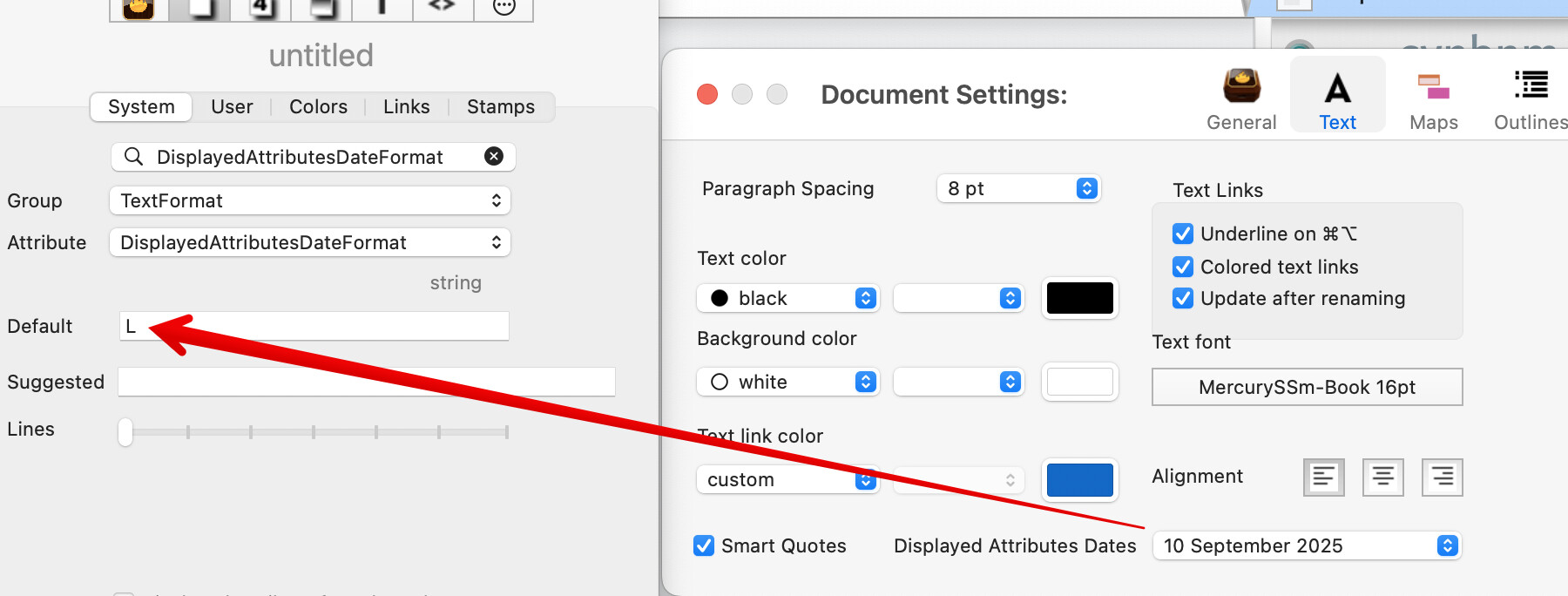

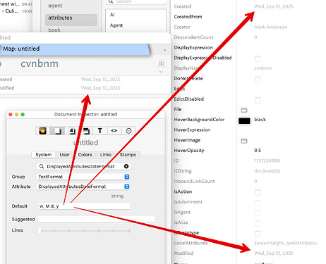

Although the Doc Settings date format picker offers only three choices, the Setting dialog is actually seeding the document level default of $DisplayedAttributesDateFormat
But we can set the latter directly in the Inspector to a value not offered in the Doc Settings pop-up.
So, “Wed, Sep 10, 2025” is format string (see info/links in previous posts) “w, M d, y”
Remember though that the format you set for I display is used for all Date attributes. You cannot have $Created display in Displayed Attributes, etc., in one format and $Modified, or $MyDate is different formats.

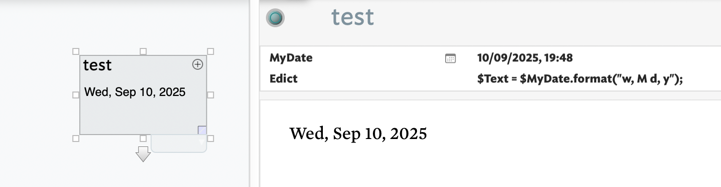

$Text = $Created.format("w, M d, y");
Demo-ed here using a Date $MyDate instead of $Created as the latter is read only and we want yesterday’s date:

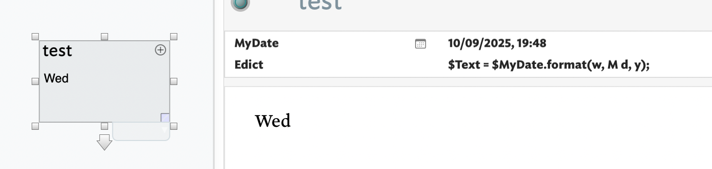

But, if I don’t follow the documentation and leave out the quotes around the date format (see the $Edict code in the Displayed Attributes table below) we get this:
