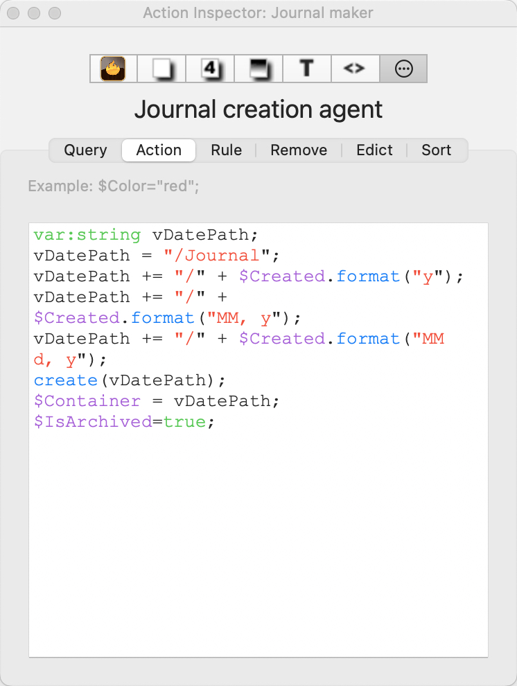

OK, yes, thatâs in ytyou code but the agent action where this occurs actually defines vDate over four lines. This is from your TBX and this:
vDatePath = "/";
vDatePath += "/" + $Created.format("y");
vDatePath += "/" + $Created.format("MM, y");
vDatePath += "/" + $Created.format("MM d, y");
could be re-written as:
vDatePath = "/"+"/"+$Created.format("y")+"/"+$Created.format("MM, y")+"/"+$Created.format("MM d, y");
So the vDatePath += part is simply a shorter way of writing vDatePath = vDatePath + . IOW we are a_adding_ more (test) to the value of vDate.
So your agent action, if a noteâs $Created date is 5th February 2023, vDatePath is:
vDatePath = "/"+"/"+"2023"+"/"+"April, 2023"+"/"+"April 5, 2023";
i.e. a string result of "//2023/April, 2023/April 5, 2023"
One obvious error is an extra â/â has sneaked in. But were you wanting:
"/2023/April, 2023/April 5, 2023"
or
"/Journal/2023/April, 2023/April 5, 2023"
or something else?
The âPinnedâ agent works as expected. So the next question is which notes are you trying to archive? Iâll take a guess you want to archive only pinned notes. To do that, the âJournal creation agentâ agent query becomes this:
descendedFrom(/Notes) & $Pinned==true & $IsArchived==false
If you want to find pinned notes anywhere the query is:
And the agent action becomes (assuming weâre still using the /Journal branch of the document for storing aliases:
var:string vDatePath;
vDatePath = "/Journal"; //altered code
create(vDatePath);
$Container = vDatePath;
$IsArchived=true;
$Pinned = false; //new code
This TBX Journal maker-cz2ed.tbx (327.0 KB) uses the latter of the two amended agent queries and the revised action. Using it, the note âAnother Noteâ at outline root and when $Pinned is ticked is detected, archived and $Pinned switched to false (un-ticked).
Does this help?
