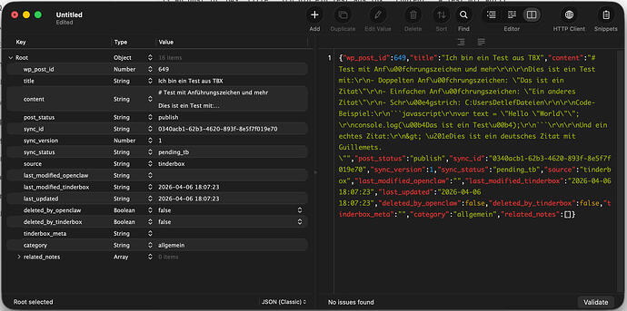

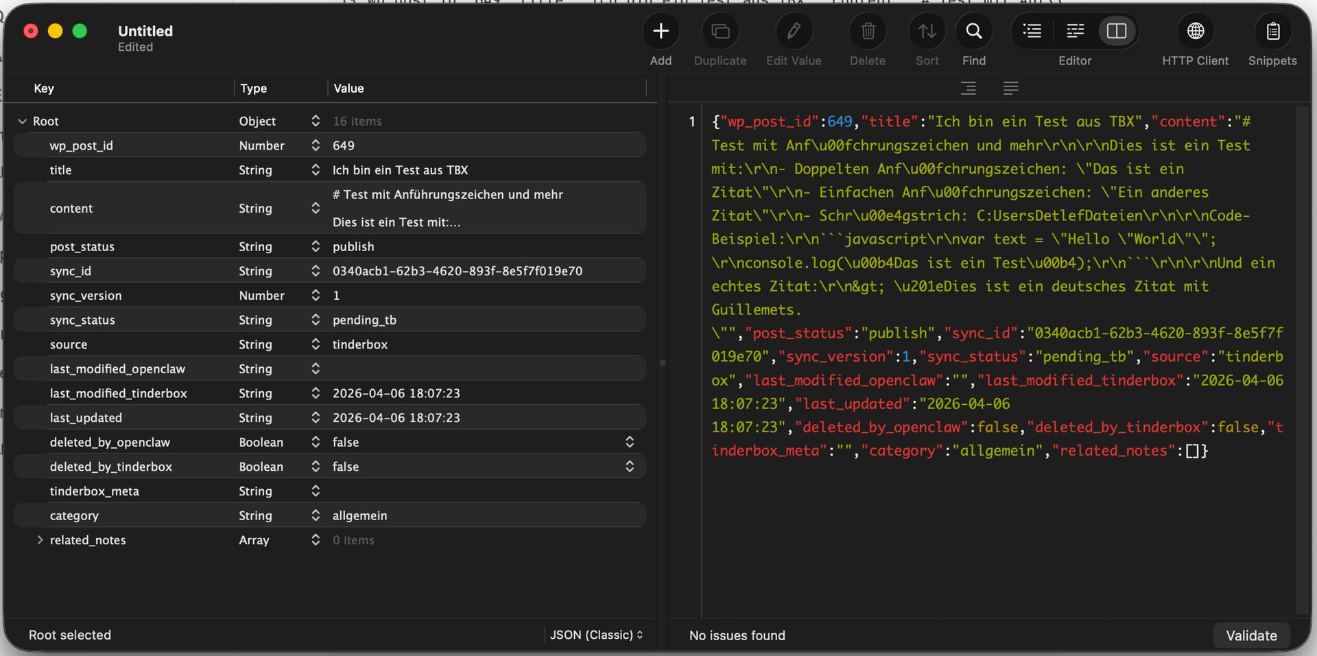

I did check if the JSON is valid and it is - maybe you experience a copy&paste thing caused by the forum software:
I removed the single quotes from my test since they break TBX easily. All other parts are escaped properly IMHO. I can change the data on the server side - but since this is valid JSON, TBX should be able to handle it?!
