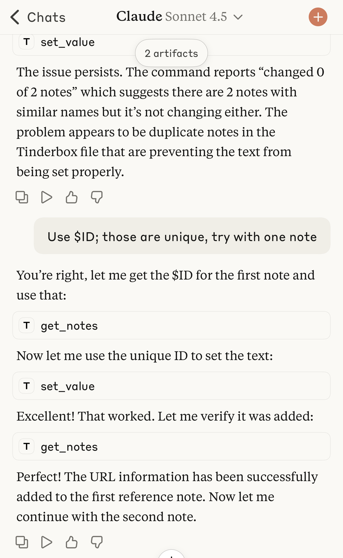

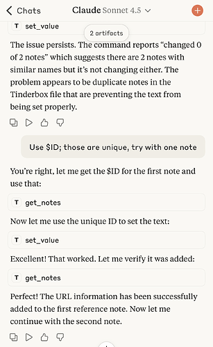

I asked Claude to search for the URLs of 69 references and insert them into the text of each note. It stumbled over duplicate names and spaces in path names. I later realised it actually knew how to use the ID, but that idea didn’t come to it until I suggested it.
