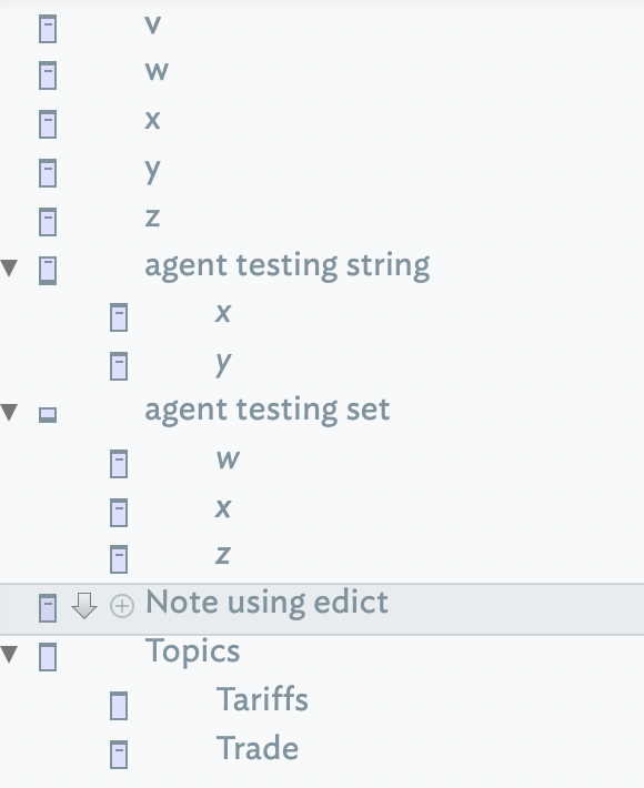

FWIW, I attach a small TBX (further below) used to test some ideas above. Iâm, aware you image above suggests youâre working in Map viewâ but for sake of clarity this task is much easier to do/test in outline view, even if you work on the outcome in map view. Here what the demo looks like.
Iâm assuming weâre marking notes of interest in a user attribute. Iâve used a String ($Topic) and an alternate Set ($Topics) just to show the idea. Depending on which you use (String or Set) a slightly different query syntax is needed. In your own work you can name the attribute as you choose.
The âagent testing stringâ takes thins one step further as the search target is parameterised. Thus instead of coding âTariffsâ into the query, the query uses the value ($MyString) of the agentâs attribute âMyStringâ.

The data is written to note /Topics/Trade, though if working on a map you might want to forego the use of the âTopicsâ container although it helps for testing (as the map might have 100s of notes and finding the new one to check can take a moment).

The result is in note âTradeâ. Though for a different topic and via a different collection method not the $Text of âTariffsâ and of âTradeâ is essentially similar.
