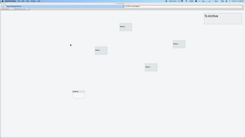

I’m using Map View to triage and process notes. I created a map with adornments that operate on notes using the adornment’s $OnAdd action. When the $OnAdd action modifies a note’s $Container and moves it out of the map view, the map jumps, see:
2025-11-21 TBX Map Jumping
See attached example TBX. I’ve also experienced refresh issues where notes don’t disappear from the map after their $Container is updated. Forcing the map to redraw resolves this.

I figured out what’s happening. When the note’s $Container is updated to a child of my Map note—in this case “Archive”—Tinderbox tries to keep that new container in view because the note is selected, causing the jump.
I solved the jumping issue by modifying my $OnAdd action to select the adornment’s container before changing the note’s $Container:
