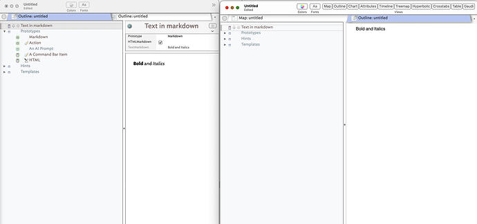

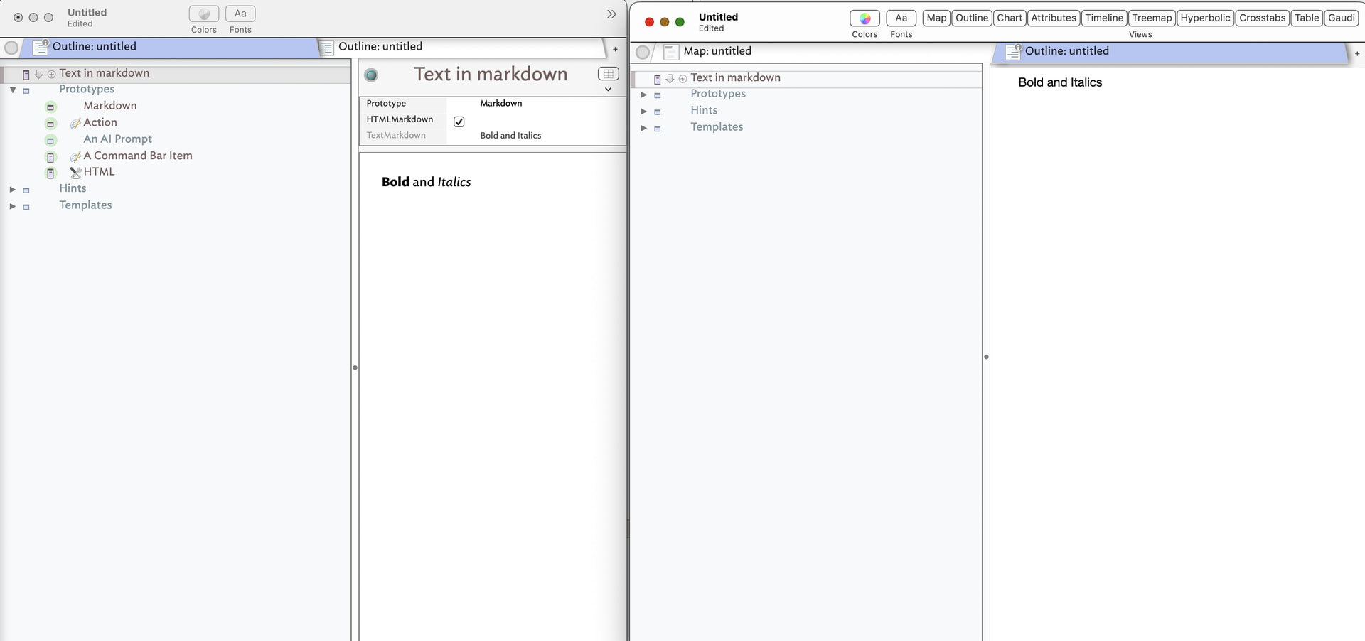

If I’ve read this extract from atbref (Markdown preview rendering) correctly…
From v11.7.0, many changes and improvements address the scenario in which the Tinderbox user has written styled text in a note, but would like a Markdown representation of the text. AI tools, for example, like Markdown. As a result, Markdown export now correctly interprets styled text like bold, italic, superscript, subscript, strikeout, and code font within $Text.
… after 11.7, I should be able to use cmd-b/i to produce bold / italics etc in a note with a Markdown prototype – without the markdown markup – and they will be rendered in the Preview.
I can’t get it to work, as these screenshots show:

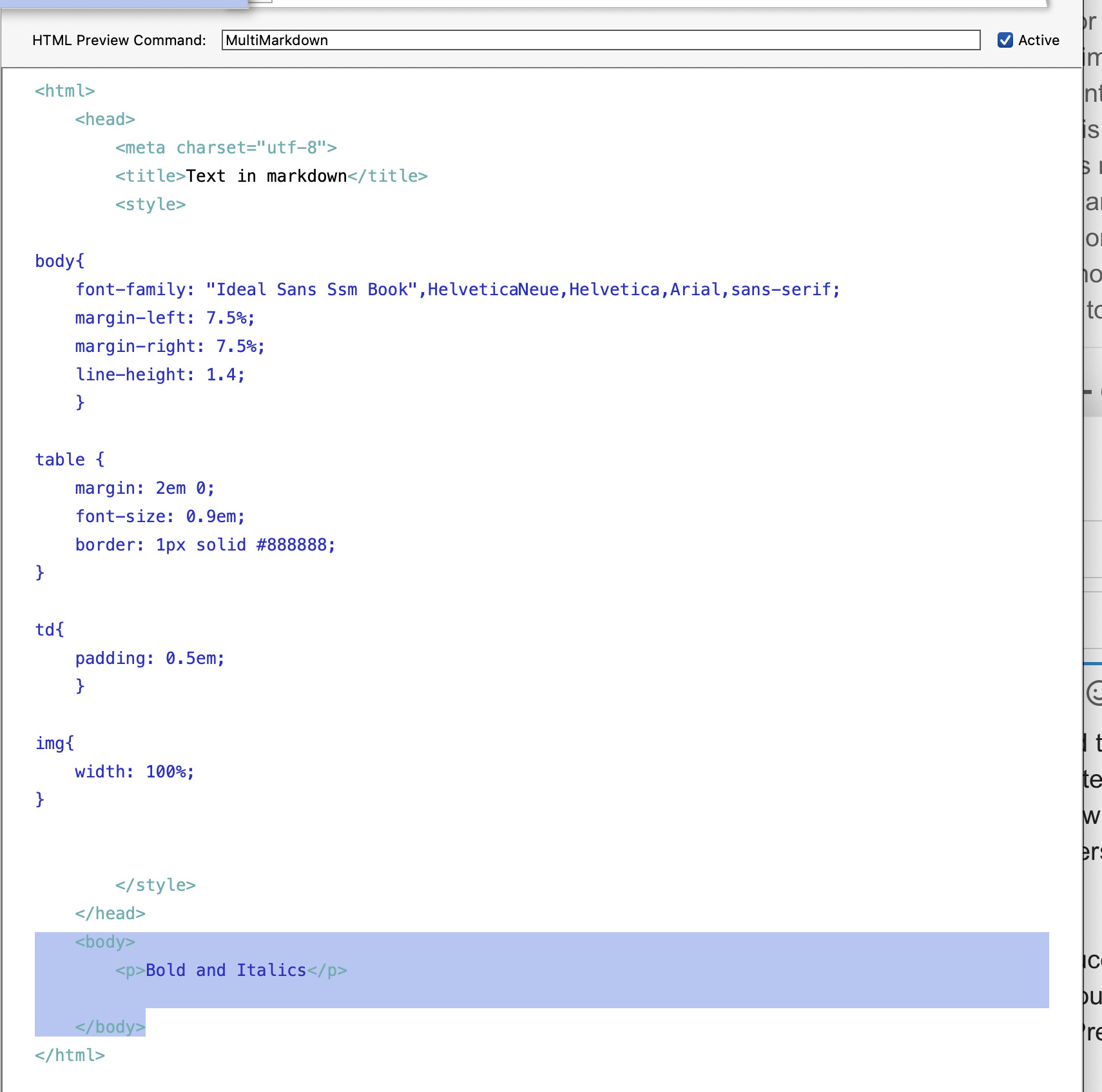

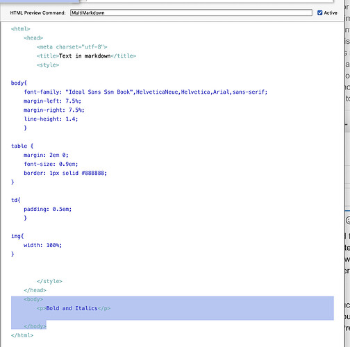

None of $TextMarkdown, the Preview, or the HML is reflecting the formatting.
What am I doing wrong, please?
Thanks!
EDIT:
Found it: to make this work, $HTMLMarkdown must be set to True, and $HTMLPreviewCommand must not have an entry, then the markdown (**bold** etc) will be automatically generated in the preview / HTML.
